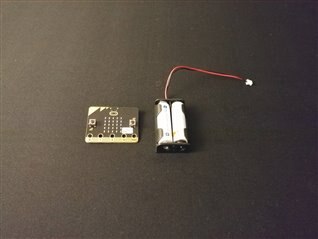

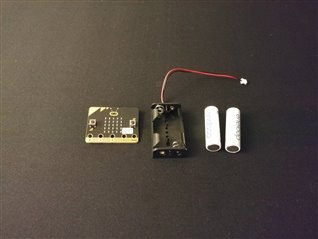

First, let’s gather all the necessary components you’ll need to build this project.
1x BBC Micro:bit
1x 3 V battery pack - This is for AA cells, feel free to use the AAA one.
2x AA batteries - I am linking the ones I used here.
Since to use a step counter you’ll want to be mobile, I am recommending a battery pack. I used 2x AA rechargeable batteries out of curiosity; if rechargeable AA cells are usually at 1.2V, will it be enough to power everything at 2.4V or less, without issues? --- The answer is, yes, it’s fine.

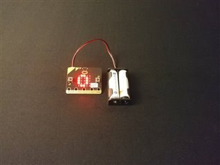

Insert the batteries into the battery holder, and plug said holder into the Micro:bit.
If everything is ok, it will turn on and display a zero. It is ready to could steps.
STEP 3
To get “steps” to show up, it definitely needs a hardy shake. You can shake it by hand and see the counter go up.
