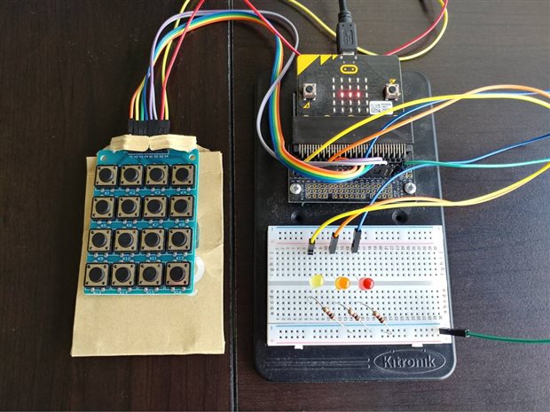

The three LED Light Show. The start of everything. (All images and videos from me.)
Like programming a sound sequence, I thought it would be useful to do the same thing with light. In this project we will start working on developing a Light Show Sequencer.
To make it simple, I will start with just 3 LEDs. I used the same kind of interface as in the Sound Sequencer project. Although the buttons are clicky, it does the job. Feel free to use any sort of keypad you want.
The goal was not only a real-time sequencing of light flashes, but also duration the light is on. So, hold the button down on one light for a long time, the program will remember the duration.

First, let’s gather all the necessary components you’ll need to build this project.
1x BBC Micro:bit
1x Kitronik Inventor’s Kit
1x Half-Breadboards
Project Wires Female - Male
Project Wires Female - Female (aka jumper wires)
3x 1k Resistor
3x LEDs of your choice (If you have the Kitronik kit, there are a few in there to use
1x 5v 2A power supply
Video demonstration of the project:
STEP 1
Load the code onto the Micro:bit.
I am providing the hex file you need to drag and drop onto the Micro:bit, and the python code as two separate files. For the below process, just use the hex file.
Plug the MicroUSB cable into the Micro:bit, and plug the other end of the cable to a PC or MAC.
At this point, you are going to copy over the code to the Micro:bit. I am providing the program (code) in this post that needs to be copied over. When the Micro:bit plugs into a computer, it shows up as a USB flash drive. All you have to do is copy the file over to the Micro:bit, like it’s a USB Flash Drive, and the Micro:bit will reset, and the program is active.
You can remove the Micro:bit from the computer at this point. The program will start running, and without the rest of the circuit, it will not function.

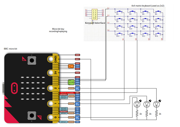

Wire up the schematic to the breakout board.
This project has a fairly large schematic.
Only 4 pins on the Micro:bit are used for the keypad. On the schematic, they are labeled R1, R2, L1, L2.
I used a 4x4 matrix keypad for this project. You can use any type of matrix keypad as long as it has eight buttons.
I then used female-female project wires to connect the pad to the Micro:bit breakout board.
Note: Pins 0, 1, 2 on the Micro:bit is the LEDs in order. So, however you want the LEDs to be arranged, keep this order in mind. Also, max current for the LEDs is 5mA. Be sure to add the resistors.
