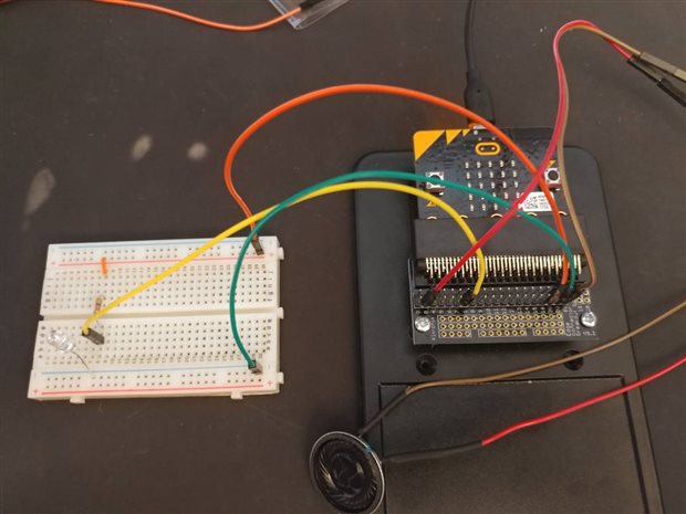

A shot of the complete circuit. (via me)

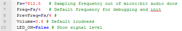

A little bit about the code:
The system itself can be fairly quiet. I suggested a powered speaker. However, you can change the volume in the top declarations.
Also, you can turn the screen LEDs on and off here too by changing the “LED_ON” variable from “True” to “False”
The rest of the code is commented fairly well if you want to see what is going on in it.
STEP 2
I used the breakout board for this project. It’s great for testing and setting up where space and reliability isn’t an issue. It also help to quickly get at the pins on the Micro:bit.
A small breadboard is definitely recommended for the phototransistor circuit.
Lay the Micro:bit and Kitronik Inventor’s Kit on a table. Insert the edge-card end of the Micro:bit into the Inventor’s Kit socket and stick a breadboard to the bottom part of the Inventor’s Kit.

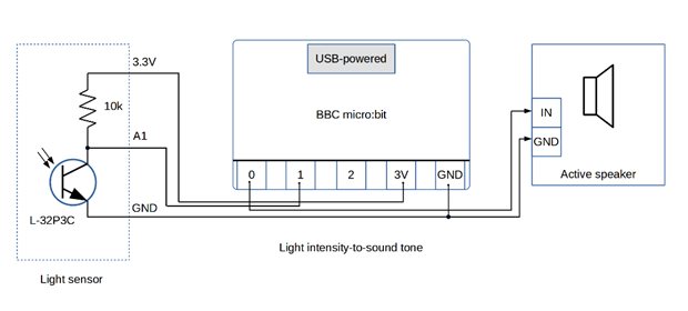

STEP 3
Wire up the schematic to the breakout board.
