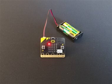

Let’s make it a mobile gaming platform too! I am recommending a battery pack. I used 2x AA rechargeable batteries out of curiosity; if rechargeable AA cells are usually at 1.2V, will it be enough to power everything at 2.4V or less, without issues? --- The answer is, yes, it’s fine. J
1x BBC Micro:bit
1x 3 V battery pack (For mobile gaming! image )
2x AA batteries

Insert the batteries into the battery holder, and plug said holder into the Micro:bit.
The game will immediately start. You’ll see the word “START” scroll across the screen first.

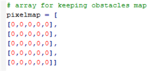

I store each map as an array. One digit for each "pixel" LED.
For generating maps, I used the random.randint() function in Python to generate pseudo-random numbers for the maps. I think as the maps go on, there are too many obstacles. So, I suggest tweaking these parameters a bit. Change x+y < 8  to maybe  x+y < 6 or even 5.

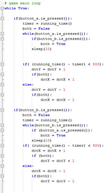

In the main game loop is where I added the constant polling of the buttons. I am taking this out to show you how you could use the buttons for a game or anything else for that matter.
First I check button A, then check button B. Eventually, one of these has to be pressed, so I start analyzing what is going on once a press is detected. The next step is to see if the other button is pressed. Then, I deal with a "simultaneous button press." In this case, the player moves at an angle on the map.
