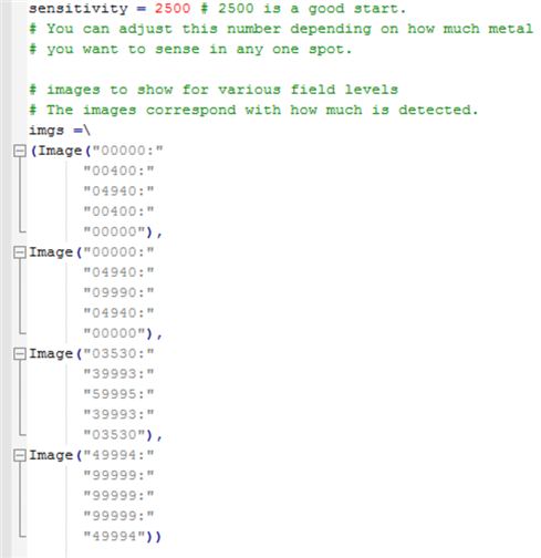

So, we have four images to see here. imgs(0)...  imgs(3)
But the base image is a single central dot, defined here:

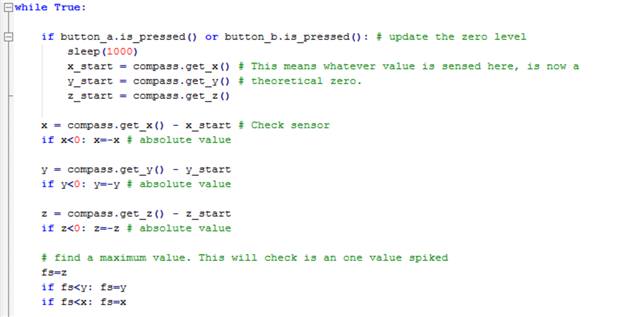

Here is where new data is sampled. This is the hard working part of the code:

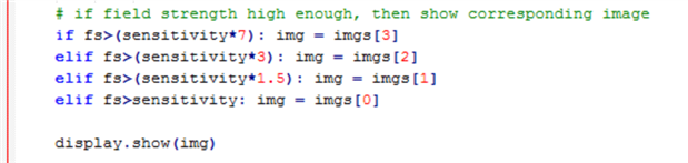

After the magnetometer data is sampled, it is compared to the base sensitivity value and the correlating image is shown.
Here is where that choice is made:

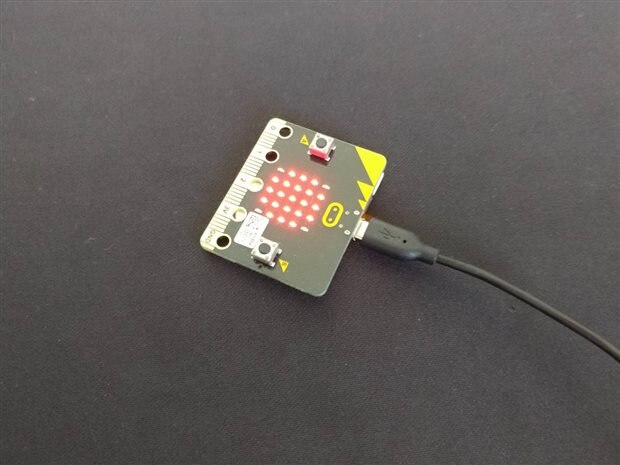

Lay the Micro:bit on a table that is not magnetic, and no ferrous metals around. Lay it there with the LED side face up.
Power the Micro:bit. I recommend some sort of power bank and use a long USB cable. Keep the battery away from the magnetometer, in other words.

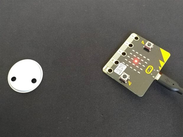

This Picture is of the Micro:bit "on" and ready to sense. (RIGHT) On the right, a piece of ferrous metal.
STEP 3
Once the Micro:bit is started, the LED screen should show a small dot or plus sign.
Now, hold the Micro:bit in the same orientation it was in when it started up. You will see the LED screen turn from a dot to a full-screen circle if there is enough metal to detect.
NOTE: If you tilt the Micro:bit, you change the magnetic field that the Micro:bit started out detecting. It’ll give false readings.
Picture - Now the Micro:bit is laying on top of the metal circle. The LED screen is showing a full sized circle - meaning, it has detected the metal object!
