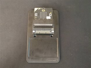

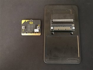

Lay the Micro:bit and Kitronik Inventor’s Kit on a table. Insert the edge-card end of the Micro:bit into the Inventor’s Kit socket.

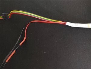

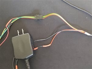

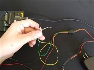

Prepare the 9V power supply. I used a 9V power supply from an old device, I think a router. But, there are better versions you could use. Like the one here at element14. You will have to splice the ends into some project wires.
I sliced the 9V positive to the LED strip’s positive voltage line. I am using this separate power supply to drive the power hungry LED strip directly. If you don’t do this, you project is going to get really hot, and eventually destroy itself.

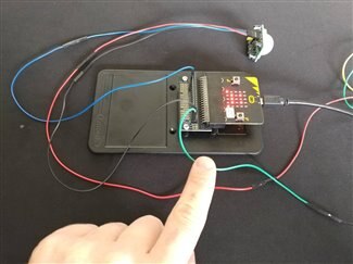

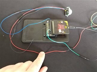

Wire up the PIR sensor, as shown in the picture. I used colors to indicate power (RED), ground (BLACK), and the signal (BLUE).
STEP 4

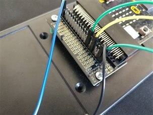

Attach the PIR sensor’s GND wire to one of the Kitronik Inventor’s Kit breakout pins labeled 0V, that’s a ground. Connect the signal line to the pin labeled P0. This is an analog input.

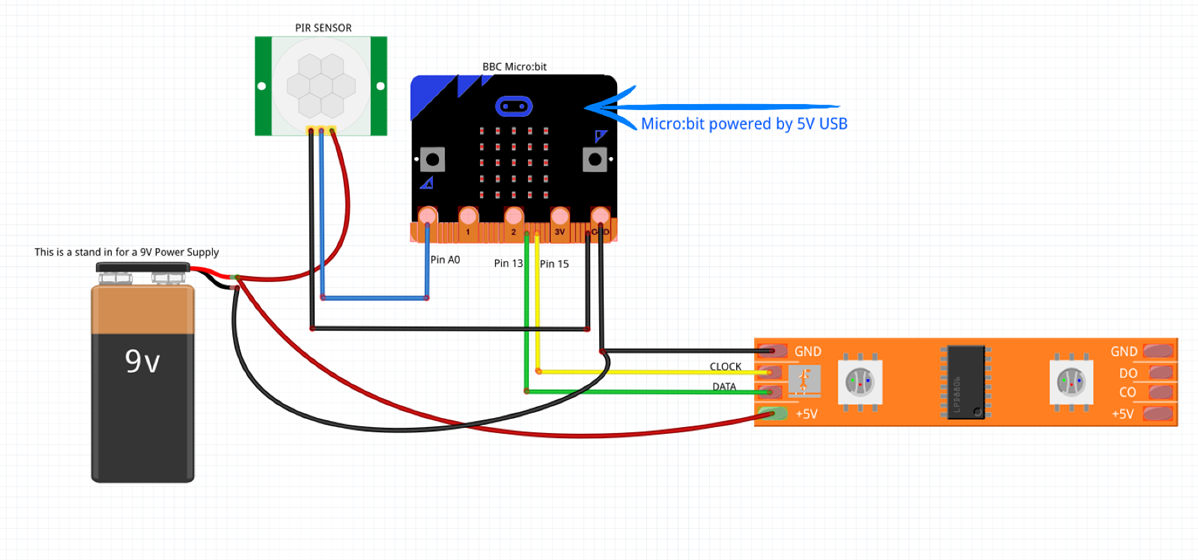

Follow the schematic below:
Connect the PIR Sensor's signal line to pin A0 on the breakout board.

Connect the 9V power supply’s positive leads to the PIR sensor directly. Then plug the 9V power supply’s ground to another of the Kitronik Inventor’s Kit 0V grounds. To complete a circuit like this, you must share grounds between the power supplies.
A side note: Why do we need to do this? The PIR sensor needs an input voltage of between 5V and 20V, the Micro:bit can only provide a 3.3V source to external devices. Also, Part 2 of the project has addressable LEDs, and we will need a beefy power supply for those.

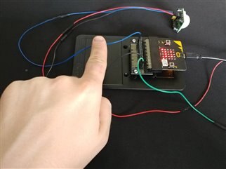

Attach the 9V positive power to the PIR Sensor directly:
Connect the 9V power supply ground, negative, to the 0V pin on the Inventor's Kit breakout board.

Attach the LED strip’s GND to another 0V pin on the Kitronik’s breakout board. Then connect the CLOCK line (yellow) to PIN 13 on the breakout board. And connect the DATA line to pin 15 on the breakout board.

Roll some construction paper into a tube big enough to house the PIR sensor. Point the white dome of the PIR sensor towards one end of the tube. What this is doing is narrowing the field of view for the PIR sensor. You could leave the PIR sensor outside of the tube, sure, but it has a near 180-degree field of vision. You’ll be triggering it with anyone moving in half the room!
