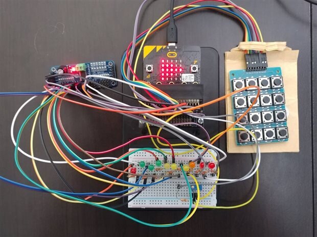

The complete and running 10-LED PWM Controller. A messy rat's nest of project wires on this project. It was unavoidable, unfortunately. (Images & video via me.)
Driving three LEDs was a good start. The real goal is to control a lot of them. My next step on this mission is controlling ten LEDs. I did do it, technically. However, I lost one key functionality, recording the sequences. The issue came down to insufficient memory for storage.
However, I was able to control the LEDs with a PWM signal from a 16 Channel 12 Bit PWM Servo Driver board. The project turned into a way to set the PWM range, apply it to the LEDs, and activate each one individually.

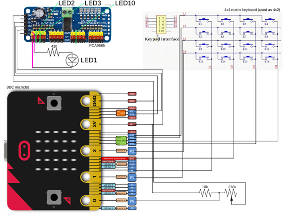

The schematic is fairly straight forward. Wire it up like the drawing. I used a breadboard for the external LEDs and potentiometer.

    Catwell over 7 years ago in reply to balearicdynamics +1
    Enrico, It's true. But, I just wanted to do a uniform pairing down the line. Blue LEDs, not used in the setup, were just too dim that way. C
    balearicdynamics over 7 years ago in reply to Catwell +1
    Cabe, I see. Somewhere I found the values of the correct resistors for different standard colors LEDs just to have the same response with PWM. https://www.evilmadscientist.com/2012/resistors-for-leds/…

    Nice project Cabe. Just a question: why in the schematic you use 430 Ohm resistor on every LED? As fara s I know, this value, especially with the red LEDs the attenuation is a bit high.
    Enrico
