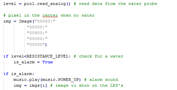

A little bit about the code:
● There is a variable called “RESISTANCE_LEVEL.” It is used to determine how sensitive the system is to water. At 1000, it would sound off to the conductivity of human skin.
The circuit acts as a voltage divider. The voltage is measured between the test source (water) and the 10k ohm resistor. The “sensor” is connected to the ADC input, showing voltages between 0 and 3.3V read in 0-1023 values.
Resistivity fun facts: Human skin is around 100k ohms on a dry surface. Broken or wet skin is around 1k ohms. Pure water, surprisingly, is up near 8 to 10M ohms per centimeter.
However, most water that would be leaking in a sink or basement isn’t pure, it’ll probably be around 10 to 30k ohms. In this project, that would read as a value of 500 to 800.
● No, I didn’t make the cool musical tones used in this project. They are from the existing BBC Micro:bit library.
A simple "import music" in the declaration will give you access to a lot of sounds.

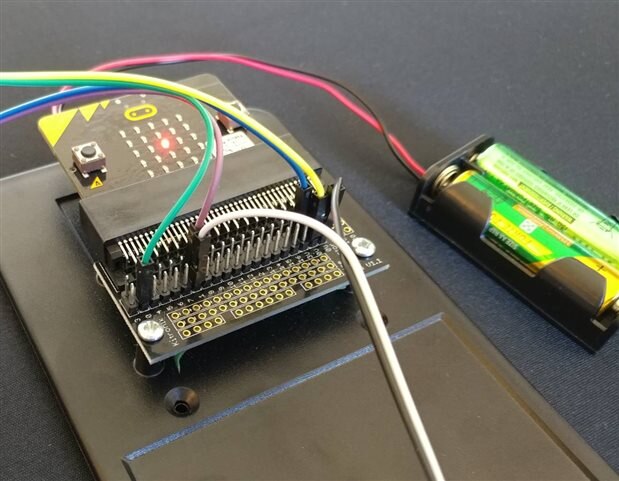

Lay the Micro:bit and Kitronik Inventor’s Kit on a table. Insert the edge-card end of the Micro:bit into the Inventor’s Kit socket.
STEP 3

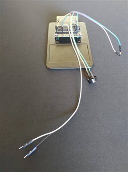

Wire up the schematic to the breakout board.
- Connect the buzzer to pins 0 and GND.
- Connect a 10k ohm resistor to pins 1 and VCC.
- Connect the wire test leads to pins 1 and GND.

Plug the battery pack or 5V wall adapter to the Micro:bit.

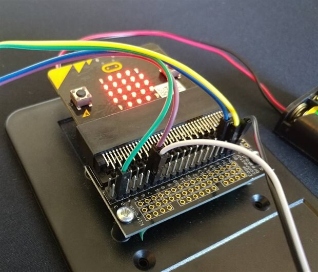

The system will turn on and make a tone, and it will immediately begin testing for water.
STEP 5
Get a cup of water and test it out. Touch the two water test leads to water in the cup.
The screen will animate, and the buzzer will go off. You’ve just detected the water!
