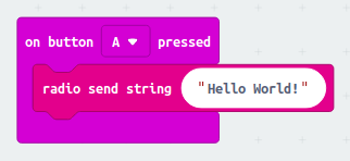

  • We'll use button A to send the message. You can send any message you like!

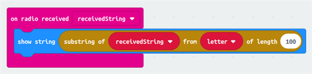

  • Now for the receiver. When we receive a message we want to show the string starting at the letter we set in the 'letter' variable. From the 'Text' section find the 'substring of' block. This takes a string (the 'receivedString' variable in our case) and cuts it starting at a letter we've chosen (the 'letter' variable in our case) and finishing after a chosen number of letters (set to 100 here so we get all the remaining letters). This is the computer equivalent of cutting words out of a magazine.

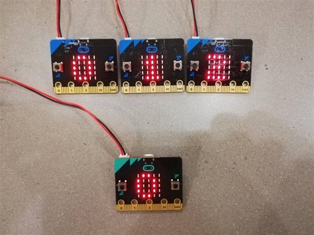

  • Connect all the micro:bits up to batteries and lay them out like this.

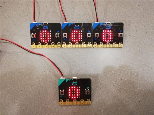

  • Press the B buttons on the top row until they are set to show letters 0, 1, and 2. If you make a mistake just reset the micro:bit (the button is on the back).

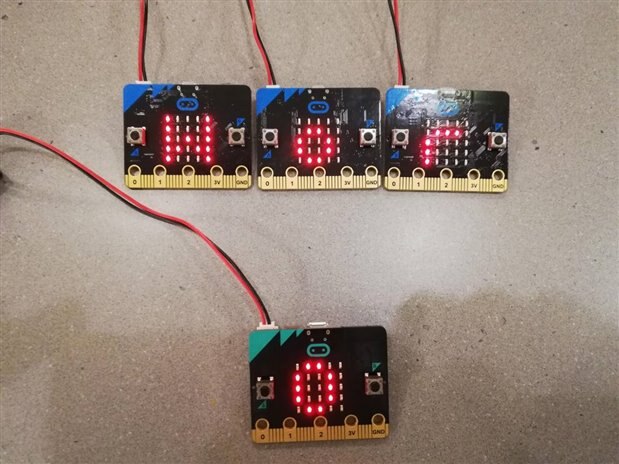

  • Press the A button on the the bottom micro:bit - you should see the message scroll across the other three!
