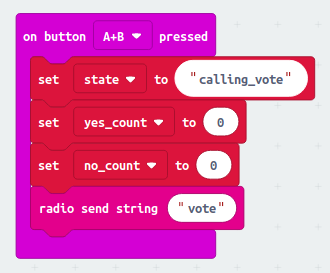

  • To start a vote we need to change to the 'calling_vote' state when A+B is pressed. We need two make two variables to store the number of yes and no votes received. We also need to tell the other micro:bits to send in their votes. We do this by sending a radio message to them - 'vote'.

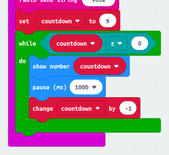

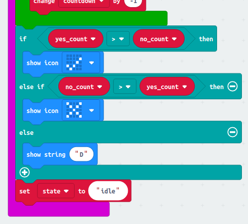

  • To give everyone some time we'll wait 10 seconds for the votes to come in. This is done by making a new variable called 'countdown' and decreasing it every second until it gets to zero. We'll display this on the LEDs so you can tell everyone to hurry up and vote!
  • After 10 seconds times up! Let's look at the votes we received and show the result! Either the result is the yes voters win, the no voters win or it's a draw. Once shown let's go back to the 'idle' state for the next vote.

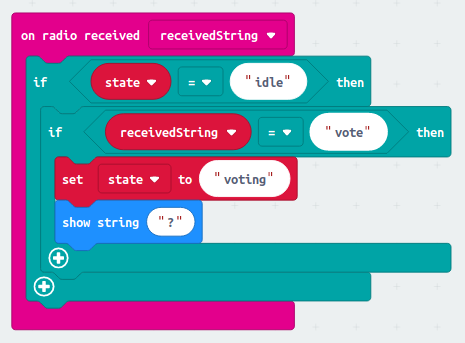

  • Now for the radio receiver. If we receive the 'vote' message and we're not doing anything else let's join in the vote. We change our state to 'voting' and prompt the user with question mark.

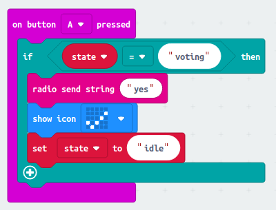

  • Vote yes by pressing A. We need to check if we're in the 'voting' state - this means we only vote when we're asked and only once. The vote is shown on the LEDs and sent as a radio message.

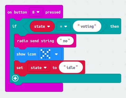

  • Vote no by pressing B. This is very similar to the yes code.

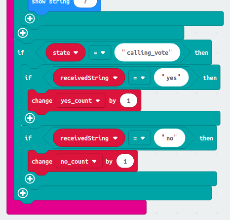

  • All that's left to do is count up the votes. Extend the 'on radio received' block to collect these votes.
