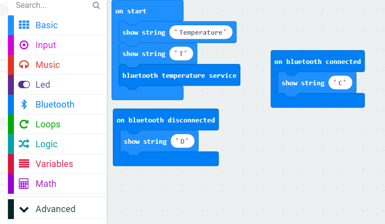

    Obviously you are pairing the different micro:bits with your Android device and connecting them for testing purposes. One known issue is that when connecting to a fresh micro:bit, or re-connecting to a previously used micro:bit, after flashing a new .hex file, the Android device may NOT pick up the Bluetooth services correctly. See here for a guide on how to fix this:
    http://www.bittysoftware.com/common.html#microbitblue2    Item 9 in the list of common problems
    And just in case. here are the MakeCode blocks for a simple program that I use for testing the micro:bit bluetooth temperature service. I'm pretty sure you don't need it image
