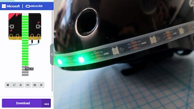

In the last video, I showed you how to turn the LEDs on and change them to show different colors. Then, I showed you how to change the duration of each color and, as a bonus, how to make an animated rainbow animation.
Building upon this, in this video I'll show you how to address the individual NeoPixel pixels to program LED animations that appear to be moving across the strip.

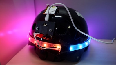

NeoPixel Strip Connected to micro:bit
First, I'll show you how to refer to each pixel's address and use the "set pixel color" block to program each pixel's color individually. The video goes into this in more detail, but the one thing to remember is that you have to call "show!"
There are two ways to animate the pixels once you draw them: shift, and rotate. I'll go over the difference between the "shift pixels" and "rotate pixels" blocks and show an example of each. Then, I'll experiment with adding pixels to the animation and changing its direction.

Since the number of LEDs on the strip is an important piece of information to keep track of when designing pixel animations, I'll go over how to store that information in a variable. This helps with remembering the number and lets us reuse this value throughout the code.
Reorganization time!
The next step is structuring the code to set-up and animate the pixels in the forever loop. I add a repeat loop inside the forever loop to repeat the rotation of pixels and go through a few examples of why and how that works.
image image
Then, to organize and reuse the code, I create a function. Functions are a way of giving sequences of code a name so that they can be reused. So, instead of repeating a bunch of blocks, I can just call the function instead. After setting it up, I add parameters to alter the speed and color of the pixel animation inside the function each time it's called!
image image
Next it's your turn! I show you how to duplicate a function and tweak it to create a new animation - like changing the "rotate one pixel" function into a "color wipe" across the NeoPixels. Your challenge is to duplicate the function and make it do whatever you want!

    For a stationary bicycle wheel you could perhaps have fireworks launching from the bottom of the wheel up the rim and then exploding when they reach the top then falling back down the rim under gravity.
    You could perhaps have a Newton's cradle type effect with balls dropping from the top of the wheel feeding a Newton's cradle type animation at the bottom of the wheel.
    For a moving bicycle then perhaps deceleration under braking could trigger comet tail type effects and a colour shift to orange and red. The harder the braking the more exaggerated the tails and colour shift.
