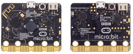

Hardware
Q) Will my Case fit? Is it the same size?
A) Yes, Very likely, the BBC Microbit has been built to the same mechanical foot print with the same edge connector and all the pins in the same place.
The only change is a slight rise in height from the speaker which should be no problem for most cases.
BBC micro:bit v2 Dimensions:
51.60mm(w) 42.00mm(h) 11.65mm(d),
Button depth to board 4.55mm,
Speaker depth to board 3.00mm
JST connector to board 5.50mm
