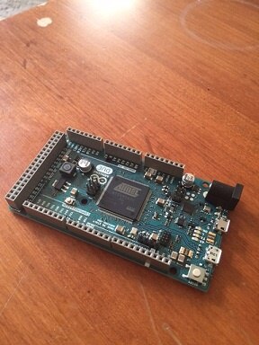

Above is my chosen stallion of a microcontroller to be used in conjunction with Matlab and Simulink; the Arduino Due gifted by element14.com. From my research I learned that the benefit of using an Arduino Due over an Uno is the faster processing power which can be helpful when negotiating data from multiple sensors. I would later learn that the most interesting capabilities of Simulink are not functional on an UNO therefore the Arduino Due is the "fete du joure" for my robot's brain!

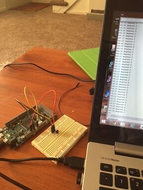

My educator's road test packet also included a TMP36 Temperature sensor. This sensor is something that I have used in the past and for learning the following Adafruit tutorial was helpful:
https://learn.adafruit.com/tmp36-temperature-sensor/using-a-temp-sensor
Past this code into an Arduino IDE to test the sensor; serial values for Fahrenheit will stream into your mind like the matrix:

Comfortable knowing that the temperature sensor was working it time to explore how to incorporate Arduino hardware with MATLAB.

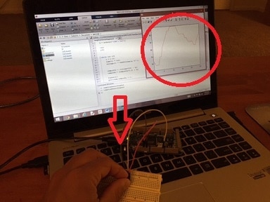

Now I wanted to produce some dynamic visualizations. Specifically, I wanted to graph the readings from my TMP36 so they appeared in a graph over time and as the readings were taken! To figure out how to do this I needed to adapt Mathu's temperature reading scripts (which would only give one reading per execution of the code) into something which records multiple values over time and then graphs as it goes. I'd need to bulk up my knowledge of MATLAB syntax and I found thisyoutube.com tutorial to help me out:
The MATLAB script I crafted is a hybrid of this video and the scripts that Mathu wrote. Here it is, and the sensor was attached to pin 'A7' :

The video here shows me running the code::
A cool feature in MATLAB is once you have a series of data points; as what I collected with my temperature sensor over time; you can visualize the same data in multiple ways with the click of the button. For example, the graph shown in the video could be turned into these trendy visualizations by selecting the "Plots" toolbar at the top of the interface:

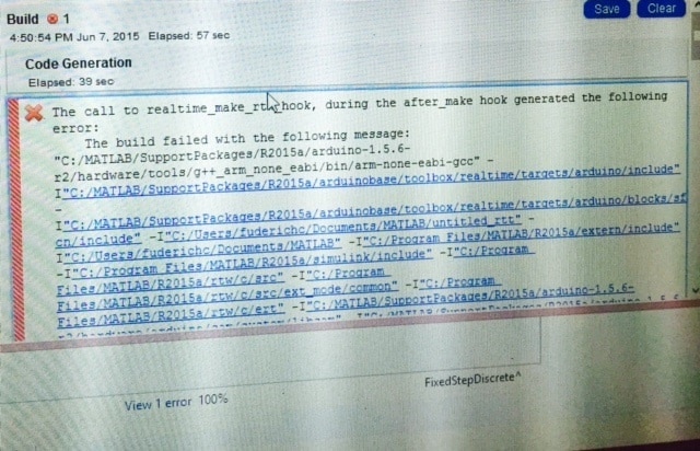

But when I began to use Simulink with an Arduino Due the hardware simply wasn't working; even though I downloaded the appropriate support packages and referenced this page for my first snippet of code:
Getting Started with ArduinoRegistered Hardware - MATLAB & Simulink Example
Simulink works by dragging and connecting blocks representing code. It's like SCRATCH programming but with some serious math incorporated into some of the blocks.In the end, all I was trying to get an LED to blink by connecting two measly blocks, as described here:

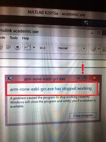

Okay, sounds easy, but then I got the following error every time I tried to execute the code on the "Due":

    Hey Kitfud,
    i was about to start using an arduino due with matlab and i encountered the exact same error:
    "arm-none-eabi-gcc.exe stopped working". How exactly did you fix this? i would really appreciate the help.

    I feel bad that I didn't help you out a bit more but I've been pretty busy. These are the steps I took to resolve my problems:
    a. Place "arduinoPreBuild.p" file in the following path:
    <Support Package Installed Path>\arduinobase\toolbox\realtime\targets\arduino\+realtime\+internal.
    (Please save the existing p file in a different location)
    b. Place "arduinoPreDownload.p" file in:
    Example:
    C:\MATLAB\SupportPackages\R2014b\arduinobase\toolbox\realtime\targets\arduino\+realtime\+internal
    Here the <Support Package Installed Path> is
    c. Then execute "rehash toolboxcache" from the MATLAB command line.
    d. Please execute "savepath" command at the end to save the search path changes at the end.
    These were instructions sent to me by Madhu, who works at MATLAB, sent me. You can probably contact him via the element14.com community Madhu Govindarajan's Blog
