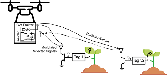

     Direct sensing can make agricultural systems safer, more efficient, more accurate, and more productive. However, agricultural applications frequently involve large, expansive areas where wireless connection for communication and power is undesirable or impracticable.  For the above reason is proposed the above low-cost, battery-free backscatter WSN with a reader/emitter box installed on a hexacopter unmanned aerial vehicle (UAV-drone). The concept is depicted in below Fig. 1. The drone will carry a battery-powered RFID reader with data logging capabilities for easy access and communication with the sensors. The drone will fly to the designated field area (vineyard for example) and retrieve the information wirelessly from the RFID based sensors. Once the flight is finished and the drone is near to the base station (home), the reader system will upload the information to the cloud via a WiFi link.
Fig. 1

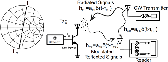

A typical backscatter communication system requires three devices: a  sensor node/tag, an emitter, and a reader. Traditional batteryless RFID systems utilize monostatic architectures thus the reader is in the same box with the carrier emitter (Fig. 2). The emitter sends a carrier wave (CW) signal which is a 868 MHz cosine in our case. The tag receives this signal and scatters a fraction of it back to the reader. The backscatter binary communication on the tag can be implemented with an RF switch (or transistor), an antenna, and a control unit (MCU).
Fig. 2

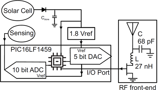

The proof-of-concept tag consists of three different parts. These parts are the MCU unit, the sensor board, and finally RF front-end. The MCU unit is the main part of the system and it is responsible for the data sensor acquisition, the implementation of the modulation symbols and the control of the other parts. The schematic of the main system is depicted in Fig. 3.  The ultra-low power 8-bit PIC16LF1459 from Microchip with current consumption only 25 uA/MHz at 1.8 V was selected for the MCU. The MCU collects data from the sensor board using the embedded analog-to-digital converter (ADC) with 10-bit resolution. The internal 31 kHz low-power oscillator was utilized as the clock source to reduce the power consumption of the tag. The MCU is responsible to supply all the other parts with voltage when it is necessary. In sleep mode, the MCU current consumption was only 0.6 uA at 1.8 V. The MCU was supplied by a low power voltage reference integrated circuit (IC) at 1.8 V (XC6504) the XC6504 provides also stable reference voltage at the ADC. A small solar panel is used to charge a capacitor with acts as an energy tank.  The MCU generates 50% duty cycle pulses that control the RF switch, thus generating an OOK modulated backscattered signal.
Fig. 3

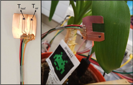

     Two different sensor boards will be fabricated for our tags, one for leaf sensing and one for soil moisture. The soil moisture sensor is a capacitive sensor consisted of two isolated conductive plates, separated by a narrow gap, on a low-cost FR-4 substrate; waterproofness will be facilitated using the solder mask as insulation. The leaf sensor board consists of two analog temperature sensors LMT84 by Texas Instruments. Each sensor is connected with an ADC input and consumes 5.4 uA at 1.8 V. The accuracy of each one is: +-0.4C and both were placed on a “clip” scheme board to be easily fixed on a leaf. A proof-of-concept prototype placed on a leaf as it is depicted in the delow figure.
Fig. 4

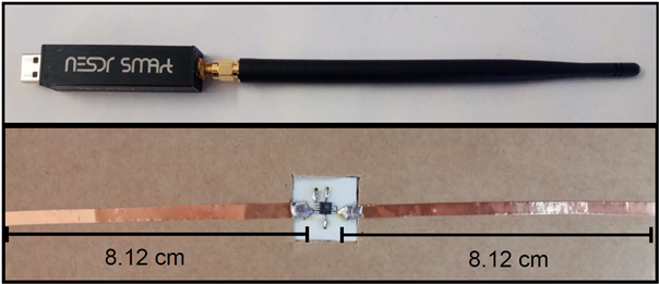

     The RF front-end part consists of an RF switch (or transistor) and a custom dipole antenna (Fig. 2). The RF front-end is connected with an I/O pin of the MCU (Fig. 4, bottom) and is necessary for the wireless communication with the reader. It is responsible for manipulating the reflections of the incident CW signal. The single-pole-double-throw (SPDT) switch ADG919 was selected due to its low insertion loss and high “OFF” isolation. The “RFC” and the “RF2” terminals of the RF switch were connected with the two elements of the dipole antenna. The dipole antenna has omnidirectional attributes and was designed for operation at 868 MHz. An RF front-end prototype has been fabricated using copper tape on cardboard substrate. The bottom picture in Fig. 4 offers the fabricated circuit and the dimensions of the antenna.
Fig. 4
     In our tag, a solar panel will charge a super capacitor instead of a battery through a low voltage drop Schottky diode. For the diode, the  SMS7630-079LF by Skyworks Inc. with forward voltage drop only 150 mV has been selected. On the tag, a real-time algorithm has been implemented in order to read the sensor information and send them wirelessly at the receiver. Subsequently, an interrupt signal coming from the reader is used to wake up the MCU. Firstly, initialization of the system (ADC, clock, I/O pins) is achieved and the ADC is enabled for data capture. The two temperature sensors are consecutively powered and the ADC reads the data from each one. The ADC is turned off immediately after this action for reducing the energy consumption. The tag was programmed to send a packet of information with  fixed format every time the algorithm is running.

     In our system, the temperature or the soil moisture ADC data are received by a low-cost SDR. This receiver is the “NESDR SMArt” SDR available by the NooElec (Fig. 4, top). It is an improved version of classic RTL SDR dongle based on the same RTL2832U demodulator with USB interface and R820T2 tuner. The USB dongle can be easily installed on a Raspberry Pi 3 single-board Linux computer.  The Raspberry Pi 3 has enough processing power run the receiver algorithm easily with the RTL-SDR.  For the emitter, a Silicon Laboratories SI1064 ultra-low power micro-controller unit (MCU) with integrated transceiver was configured to transmit a sine/cosine wave at UHF frequency 868 MHz, with a transmission power of 13 dBm. The SI1064 can be used alternatively for the reader instead of the RTL-SDR but it is required more time for research and implementation.
