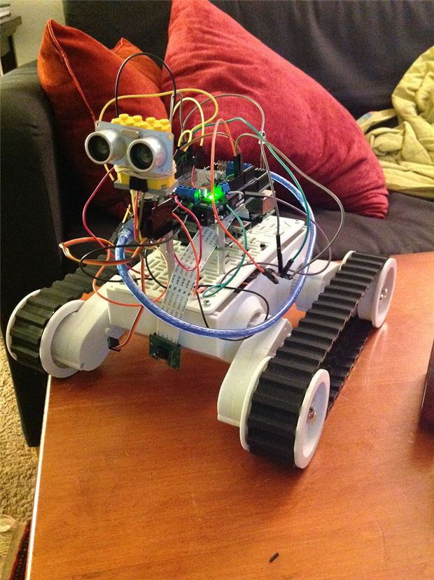

Now that it's the Christmas holidays I've had plenty of time to work on my robotics stuff as a hobby. Below is my "Fat Cat" robot made of a Dagu 5 robot chassis, a Raspberry Pi B+ an Arduino Mega along with the lovely Pi Camera board:
I call it the "Fat Cat" because I think my cat thinks it's a living entity. Moreover, she is much smaller than this mash-up of electronics. Anyway, this Fat Cat is the culmination of what I have been able to achieve thus far in my robotics career. Let me ruminate on the past by presenting my obstacle avoiding "Dragon Bot".....
Oh what good times! The video's artistic flair may take away from the seriousness of the obstacle avoiding genius. The problem with this type of contraption though, is that you can't just yell at it to stop like a golden retriever in your favorite park. No! Instead you have to chase it all over the floor, pick it up and then turn it off manually which is an inconvenience when you think about how we are living in the year 2014; the year of the internet and ultra high def TVs...yada...yada...yada....

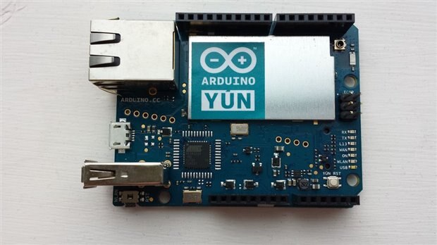

Anyway, I eventually invested in an Arduino Yun, a wifi version of a regular Arduino in an attempt to gain remote control over my aimless obstacle avoiding Dragon Bot! Below is a picture of an Arduino Yun which, like the Raspberry Pi, has a LINUX processor embedded  onboard:
It is quite a snazzy little micro-controller but the way I'd drive my updated Dragon Bot was through entering commands in the Yun's version of the serial monitor called Console. It can't be called a Serial Communication because it is not actually attached to a computer but living in the nether world of wifi image.
By entering in letters and sending them through the Arduino Console I could drive my robot around and then with the sending of a key stroke I could set the robot into obstacle avoiding "autopilot" mode. Then bring it back under my control (like a little zombie) through another keystroke. However, because I was using Console  I could not use Python and the Pyserial library to create a graphical control interfaceimage. This is an Arduino bummer, and is why the Raspberry Pi came into play when I developed the "Fat Cat." But I must get back to the point, and not let my ramblings about the Fat Cat detract.
