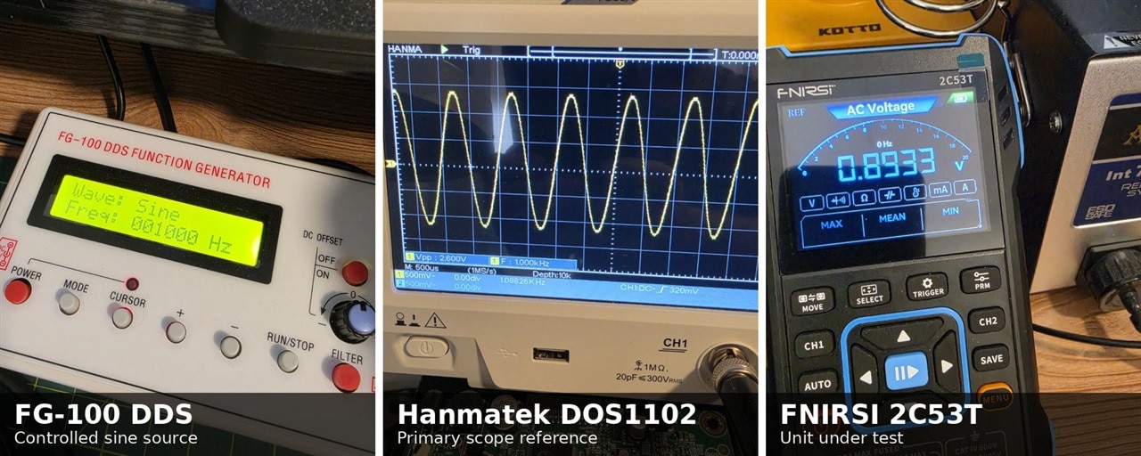

2.1 How I separated source behavior from meter behavior
The biggest change I made as the testing progressed was to stop treating every handheld reading as the reference. For the AC-frequency sweep, the Hanmatek scope became the source-amplitude check. The generator was held on a sine wave while the scope continued to show about 2.60 to 2.62 Vpp from 1 kHz through 4 kHz. That let me separate a falling handheld AC reading from an actual collapse of the generator output.
For a sine wave I used Vrms = Vpp / (2 x sqrt(2)) to convert the scope-observed peak-to-peak value into a useful RMS comparison. A 2.600 Vpp sine corresponds to about 0.919 V RMS, and 2.620 Vpp corresponds to about 0.926 V RMS. These are derived comparison values, not separately calibrated RMS measurements from the scope.
For the later RF endpoint checks I switched to the tinySA LOW output because the FG-100 could not cover the full oscilloscope bandwidth. I used the tinySA as the high-frequency source and the Hanmatek DOS1102 as the independent reference at each fixed test frequency. That arrangement let me confirm that the 2C53T could acquire and identify signals through 50 MHz, while also showing why the amplitude data should not be treated as a calibrated -3 dB bandwidth measurement without a properly controlled 50-ohm fixture.

Confidence grading used in this review: DC agreement, the 2859/2860 Hz AC-mode boundary, and the direct 400 Hz false-frequency captures are high-confidence observations because they were repeated or independently cross-checked. The long-timebase 100 Hz behavior is useful but more dependent on sampling and display settings. The YU6 output captures are context only and are not used by themselves to claim an instrument fault.
Figure 2. Core test instruments used for the repeatable source, reference waveform and FNIRSI checks.

4. Multimeter results: AC voltage and frequency-dependent behavior
The AC side is where the story becomes more complicated. At low audio frequencies the FNIRSI gave sensible readings and was close to the reference meter. Around 1 kHz, for example, I recorded roughly 1.00 V on the Multicomp Pro and about 0.995 V on the FNIRSI.
As I increased frequency, the indicated AC voltage on both handheld meters began to change even though the Hanmatek continued to show the generator waveform present. That is an important point. The falling meter reading does not automatically mean the generator stopped producing the waveform. It tells us that the AC measurement chain and its frequency response have become part of the test.
The FNIRSI also has another behavior layered on top of that. Once the indicated AC level dropped to about 0.8 V during this sweep, the unit began falling back into its automatic mode instead of continuing to hold the AC-voltage display. I narrowed that handover down with a short one-hertz-at-a-time check rather than repeating the whole sweep. In this setup the transition was around 2.86 kHz, with the FNIRSI showing roughly 0.800 V AC right at the edge before the next small frequency step pushed it back to AUTO.
I am not treating 2.86 kHz or 0.800 V as a hidden specification. It is simply the repeatable boundary I observed with this generator level, this waveform and this particular unit. The useful finding is the behavior itself: the AC-voltage mode has a practical frequency/level limit, and when that limit is reached the instrument can leave the measurement mode rather than just continue with a lower-confidence number.

4.1 What the final sweep shows
This final sweep is stronger than the earlier spot checks because the source amplitude was watched on the Hanmatek while frequency was changed. The scope remained at about 2.60 to 2.62 Vpp, so the large fall in handheld AC readings was not caused by the sine wave disappearing. The Multicomp also rolls off, which is a useful reminder that a True-RMS label does not automatically mean flat response at every frequency.
Data Chart 2. Final sine sweep. The scope-derived RMS line stays essentially flat while both handheld AC readings become frequency dependent. The FNIRSI stops returning an AC-voltage value at the 2860 Hz step.
Data Chart 3. Same sweep expressed as percentage of the RMS value derived from the scope Vpp. This makes the frequency-dependent response easier to compare across instruments.
At 1 kHz, the final-sweep FNIRSI reading was about 97.2% of the scope-derived RMS value. At 2 kHz it was about 94.2%. At 2.5 to 2.859 kHz it was roughly 87 to 90%, then the unit changed to AUTO between 2859 and 2860 Hz. The 1 Hz step size only tells me where the transition occurred in this setup; it does not turn that point into a guaranteed product specification.
The Multicomp data also became strongly frequency dependent: approximately 96.8% of the scope-derived value at 1 kHz, 70.2% at 3 kHz, and 40.9% at 4 kHz. I included this because it prevents the wrong conclusion that every disagreement above 2 kHz belongs to the FNIRSI alone.
Important limitation: I would describe the roughly 0.8 V / 2.86 kHz point as an observed transition in this setup, not as a published threshold specification. It was repeatable enough to document, but waveform, level, source impedance and unit-to-unit variation could move it.

9. Built-in signal generator characterization
The built-in signal generator ended up being one of the stronger parts of the 2C53T. I tested it independently with the Hanmatek DOS1102 rather than looping the generator back into the FNIRSI and asking the instrument to grade itself. The box specifies a 1 Hz to 50 kHz generator range and 0.1 to 3.0 V amplitude setting, so those were the limits I tried to verify.
9.1 Frequency range and accuracy
Programmed
Hanmatek result
Approx. error
Result
1 Hz
period visually consistent with ~1 Hz
reference auto-counter not used
Pass
2 Hz
2.00009 Hz
+45 ppm
Pass
4 Hz
4.00019 Hz
+47.5 ppm
Pass
5 Hz
5.00023 Hz
+46 ppm
Pass
10 Hz
10.0005 Hz
+50 ppm
Pass
1 kHz
1.00005 kHz
+50 ppm
Pass
10 kHz
10.0005 kHz
+50 ppm
Pass
50 kHz
~50.00 kHz
within displayed resolution
Pass
The low-frequency reference counter itself became unreliable in scan mode at the very bottom of the range, so I did not turn the 1 Hz auto-counter number into a false precision claim. Instead I judged the waveform period from the graticule. From 2 Hz upward, the measured frequency tracked the programmed value extremely closely. The repeated roughly 45 to 50 ppm offset through several points is small enough that the generator is more than adequate for general troubleshooting and learning work.
Data Chart. Built-in generator frequency error. The 1 Hz point is excluded from the ppm plot because the bench scope auto-counter was not reliable in the slow scan condition.
Figure. Bottom and top of the advertised generator range: 1 Hz and 50 kHz.
9.2 Amplitude setting vs measured output
Generator setting
Hanmatek measured Vpp
Difference
Percent high
0.1 V
0.126 V
+0.026 V
+26.0%
0.5 V
0.528 V
+0.028 V
+5.6%
1.0 V
1.008 V
+0.008 V
+0.8%
2.0 V
2.120 V
+0.120 V
+6.0%
3.0 V
3.120 V
+0.120 V
+4.0%
Amplitude accuracy was not as impressive as frequency accuracy. The 1.0 V setting was very close in the captured test, while the 0.1 V setting showed the largest percentage error. The upper settings were consistently a little high. For ordinary circuit stimulation this is still useful, but I would verify the actual output with a scope or meter whenever the exact stimulus amplitude matters.
Data Chart. Programmed generator amplitude compared with the Hanmatek Vpp measurement. The dashed line represents a perfect 1:1 result.
Figure. Example amplitude checks captured at 1 kHz.
9.3 Waveform set
I also stepped through the available waveform shapes. The useful part here is not just that the menu contains several names, but that the outputs were visibly distinct on the independent scope. I confirmed sine, square, half-wave, full-wave, step and reverse-step outputs, along with the variable-symmetry ramp / sawtooth mode.
Figure. Representative built-in generator waveforms observed on the Hanmatek reference scope.
9.4 The sawtooth duty-cycle control is really a symmetry control
The sawtooth mode deserves extra explanation because the user interface calls the adjustable parameter duty cycle. At 50% the output becomes essentially a symmetrical triangle. Moving the setting away from 50% changes the relative rise and fall times, progressively turning the triangle into a rising or falling ramp. Moving to the opposite side of 50% reverses the direction. In practice this is more flexible than a fixed sawtooth output, although the menu wording does not make that behavior obvious.
Figure. Sawtooth / ramp symmetry behavior. Around 50% the output is triangle-like; moving the control to either side changes the slope relationship and ramp direction.
9.5 Generator verdict
This is one feature I would count as a real advantage of the 2C53T rather than a box-checking extra. The generator reached the advertised 1 Hz and 50 kHz endpoints in my testing, frequency accuracy was very good over the measured points, and the waveform selection is genuinely useful. The amplitude setting is not something I would treat as a calibrated voltage reference, but for learning, injecting a signal into a circuit, checking an audio path or creating a quick clock / test waveform without carrying another instrument, it adds real value.

AC voltage vs frequency
~1 kHz upward; final boundary check near ~2.86 kHz
Low-frequency AC readings were sensible. As frequency rose, the handheld readings changed while the Hanmatek still showed the source waveform. In the final repeat the FNIRSI was near 0.800 V AC at the boundary, then fell back to AUTO on the next small step.
Documented operating limitation / behavior, not treated as a universal specification.

Appendix A2: Final controlled AC sweep
Freq
Scope Vpp
Derived RMS
Multicomp
FNIRSI
FNIRSI state
1000 Hz
2.600 Vpp
0.919 V
0.890 V
0.8933 V
AC
2000 Hz
2.600 Vpp
0.919 V
0.880 V
0.8656 V
AC
2500 Hz
2.620 Vpp
0.926 V
0.755 V
0.8340 V
AC
2750 Hz
2.620 Vpp
0.926 V
0.705 V
0.8114 V
AC
2800 Hz
2.600 Vpp
0.919 V
0.694 V
0.8255 V
AC
2859 Hz
2.600 Vpp
0.919 V
0.681 V
0.8001 V
AC
2860 Hz
2.600 Vpp
0.919 V
n/c
n/c
AUTO
2875 Hz
2.600 Vpp
0.919 V
0.680 V
n/c
AUTO
2900 Hz
2.600 Vpp
0.919 V
0.671 V
n/c
AUTO
3000 Hz
2.600 Vpp
0.919 V
0.645 V
n/c
AUTO
4000 Hz
2.620 Vpp
0.926 V
0.3786 V
n/c
AUTO

Strong feature.
Generator duty/symmetry behavior
COMPLETE FOR OBSERVED MODES
Sawtooth control acts as symmetry control: 50% triangle-like, moving either side changes ramp direction/slope.
Document UI terminology clearly.
Battery runtime / charging
QUALITATIVELY CHARACTERIZED
No timed rundown was performed, but repeated multi-hour use throughout the review required only two or three proactive charges and never interrupted a test session.
Strong real-world portability result; exact runtime not claimed.
USB grounding/noise behavior
NOT CHARACTERIZED
USB file sharing works, but effect of USB connection on scope grounding/noise was not systematically measured.
Worth one safety/usability check if easy.
Scope input noise floor
NOT CHARACTERIZED
No deliberate shorted-input/no-signal Vpp/RMS noise test at sensitive vertical ranges was recorded.
Quick optional test; useful if final completeness is desired.
Firmware / update experience
PARTIAL
Firmware version observed earlier, but update availability/process was not a major part of the characterization.
Optional contextual note only.
