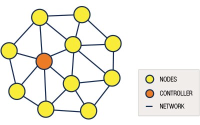

Normally, a wireless network has a central controller that requires a direct radio link from the devices or nodes. When any disturbance occurs in the nodes, the controller does not have any backup route to reach the nodes. In a Z-wave system, this limitation has been overcome. An individual node can work as a repeater. If any node is not in the direct line of sight of the controller, this repeater node can interact with the other nodes and the controller can continue to communicate with the node which is not in the direct radio link.
A controller can communicate with every device in the network (See figure on left). It has access to the complete routing table. Slave nodes can only reply to the node from which the message has been sent and it has no information about the routing table. When the node works as a routing slave, it has partial knowledge about the routing table and can reply to the node from which the message has been sent and can send a message to a number of predefined nodes it has a route to.

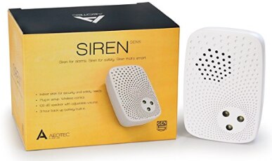

Aeotec Z-Wave Plus Siren
