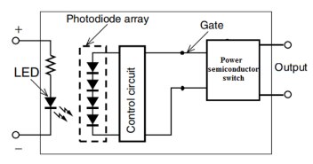

A typical solid state relay is designed as an on-off switch with a low power input terminal and a high power drive output terminal.  Figure 1 indicates the internal diagram of a typical SSR.
Figure 1: Internal diagram of a typical Solid State Relay
The SSR is constructed using a light emitting diode (LED), photodiode dome array (PDA), a control circuit, and one or more semiconductor switches. A series resistor is used to limit the input current.  The low voltage input drives an LED to generate a light source which is further detected by the PDA. The combination of LED and PDA provides optical-isolation and helps to transfer the input signal to the gate control circuit. Semiconductor switches such as SCRs, TRIACs, bipolar transistors are used to drive the flow of source current to the load. SSRs support both AC and DC waveforms, but the internal configuration has to be modified to work for either scenario.

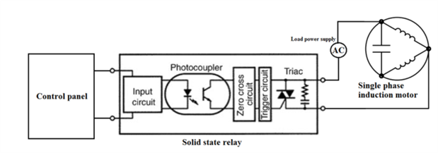

Figure 2 shows a TRIAC-based AC-operated relay circuit diagram. In this example, an in-built input circuit is used to limit the forward dropout voltage for the LED.
Figure 2: Diagram of AC operated TRIAC-based relay circuit
The zero crossing detection circuit is used to take the reference of positive and negative cycles of the AC voltage. The control panel provides an input signal to the terminals of the solid state relay. Using that signal, the triggering circuit generates the gate plus for the TRIAC. During on-time, the TRIAC allows the AC voltage to the load (induction motor). A Resistor-Capacitor (RC) snubber network is required across the output terminals to protect the semiconductor device from noise and voltage transient spikes.

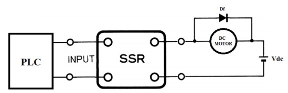

SSRs are well suited for industrial applications such as solenoid controlled valves, temperature controllers, motor controllers, and lamps. Figure 3 shows a block diagram of a DC motor controller where an SSR acts as a DC motor drive to control a solenoid or an electromechanical valve. The Programmable Logic Controller (PLC) provides the control signal to the SSR to operate the DC motor. The DC motor usually creates back EMF (electromotive force). If the electromotive force exceeds the withstand voltage of the SSR output element, it could result in damage to the relay output element. To prevent this, connect a freewheeling diode (Df) in parallel with the DC motor.
Figure 3: DC motor controller

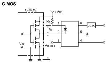

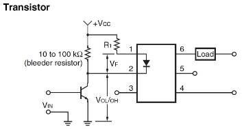

Refer to Figure 4. The LED input side of the MOSFET is driven by current. When applying a voltage, add resistance in series with the circuit, so the specified current is applied. This resistance is referred as "LED current limiting resistance".
Figure4: Typical MOSFET Relay Driving Circuits
To ensure that the MOSFET relay operates correctly, use the following formula to calculate the limiting resistance, and design the circuit accordingly.

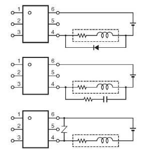

Protection from Spike Voltage on the Output Pins of the MOSFET Relay
If there is an inductive load or other condition that will cause an overvoltage that exceeds the absolute maximum rating between the output pins, connect a protective circuit to limit the overvoltage as diagrammed in Figure 5.
Figure 5: Spike Voltage Protection Circuit

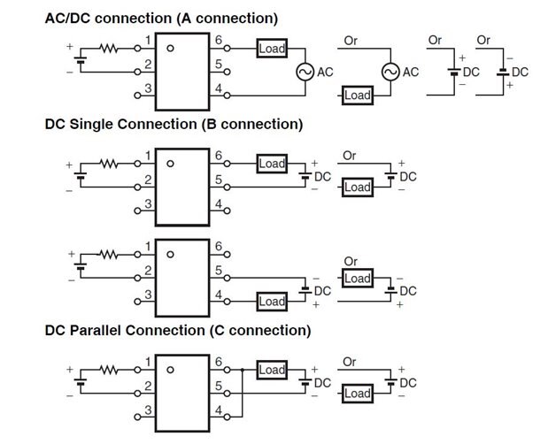

Load Connection Examples of a MOSFET Relay
.image
Figure 7: Example of correct connection
