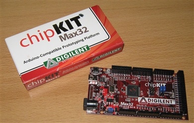

I’ve  been a big fan of Microchip PICs for some time now, possible because I  use them everyday at ebmpapst. My passion for them seams to have not gone on  noticed as Microchip have supplied me we the latested Arduino clone or  look a like - The chipKIT Max 32. However Microchip have been a bit hit  or miss with development kits so I was intrigued to see how well this  would stand up to review especially as they are not developed by  themselves but by Digilent.image

Keeping  the coding till last I next looked at the physical hardware closer. All  is pretty good I have to say, well built and very well labeled up with  whats what on the board. There are two sets of jumpers, one that allow  you to select the power input, bypassing the regulator allowing a higher  voltage to the power connector. The other is to allow putting the PIC32  into either master or slave SPI mode due to a little pin shuffling  that's required. Both are good however the links stand taller than the  connectors around the outside of the board. So plugging in a shield is  not going to go home fully and solid. It may only be millimeters but  still a design oversight in my view.
On  the subject of shields then I have found that the community have been  having problems - the chipKIT is not claiming to be 100% compatible and  that's because its not. Some of the pin mapping from what I have read  manes that some shields will not work. My advice is to visit the chipKIT  community - which is very good - and check for compatibility. There is  also no Ethernet shield available (at the time of writing this) but  Digilent are designing one that is chipKIT compatible. That I think will  disappoint some and the other for me was that there is nowhere to fit a  32kHz crystal so I could use the already on chip RTCC and last of all, why is  the ICSP socket (not fitted) have staggered holes?
