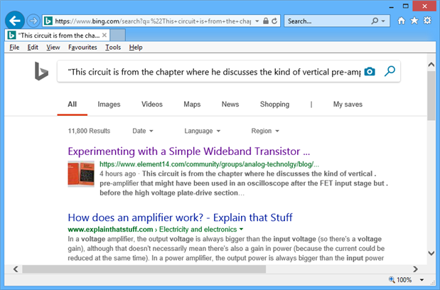

    This post was, in part, an experiment to see how a blog in an old, somewhat moribund group that hasn't had anything posted to it since 2017 would get indexed by a search engine.
    See this thread if you want the background to this: Where would you expect the different kinds of blogging content I produce to be found?
    Here is the result of searching Bing
    So at least one of the major search engines has picked it up within a few hours.
    That's in contrast to my own blog here which doesn't seem to have been crawled in the several years I've been posting to it.
    Is there any chance cstanton  that this particular group could be changed so that:
    a) it has a sensible name ('Analog Design' is good, 'analog technology' sounds like a marketing brochure);
    b) the name is in capitals (to match the other major groups);
    c) the URL had correct spelling?
