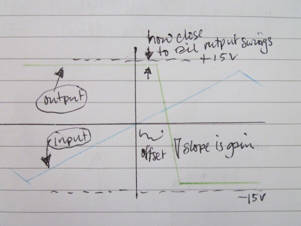

So how to look at it and measure it? This was going to be easy, I thought. Dredged up from the
rank depths of my memory was a circuit that would show me not only the input voltage offset
but also the open-loop gain and how close to the rails the outputs could get. I don't know
where I might have seen it and can't find it now. It might have been a book, an application
note, or maybe even online. Or maybe I imagined it.
The circuit was something like this
and the result would be along these lines:

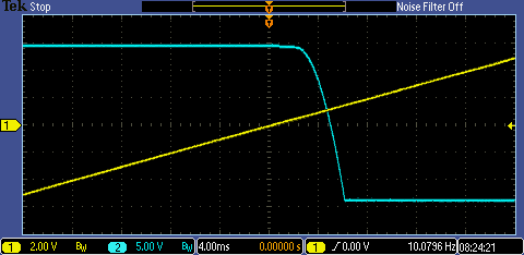

The input is a triangle wave and is simply attenuated by a factor of approximately 1000 by the
resistors, giving better control of the mV-level signal at the input.
I should have thought a bit harder about what the result might be but, in a fit of enthusiasm,
I quickly repurposed one of my old test pcbs
and tried it on some of the odd selection of op amps I've accumulated over the last couple of
years.

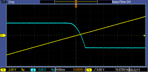

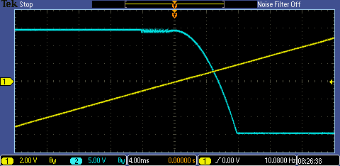

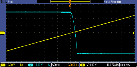

Here are the results
TL081
OP177
ICL7611 [powered from +8v, -8V rails]
OP27
They look plausible but there's a snag. I can't show you because I didn't save a trace of it,
but the output always lagged the input zero-crossing point, irrespective of whether the input
was on the ramp up or the ramp down. If it represented the offset, it would have lead one way
and lagged the other. So what am I looking at? A further clue is the rounded corner where the
output starts to move. I'm looking at how the op amp output behaves when it comes out of
limiting at the rail, and it doesn't hurry, does it? The plots do show me how close the
outputs can get to the rail, so it wasn't a total fail as an experiment. The results are fine
for showing how the parts behave as comparators [not too good, if you like fast and snappy],
but the offset is quite overshadowed by the slow recovery.

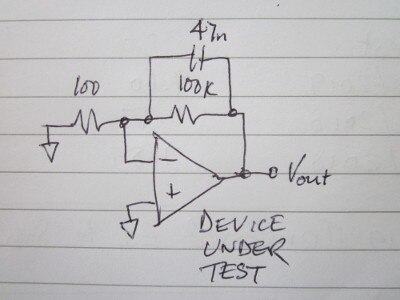

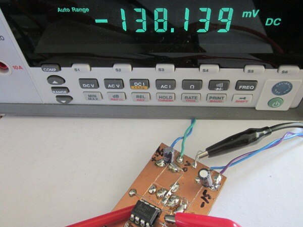

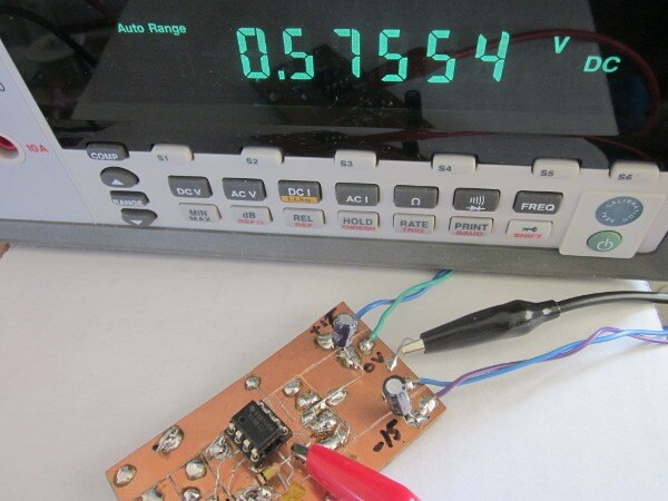

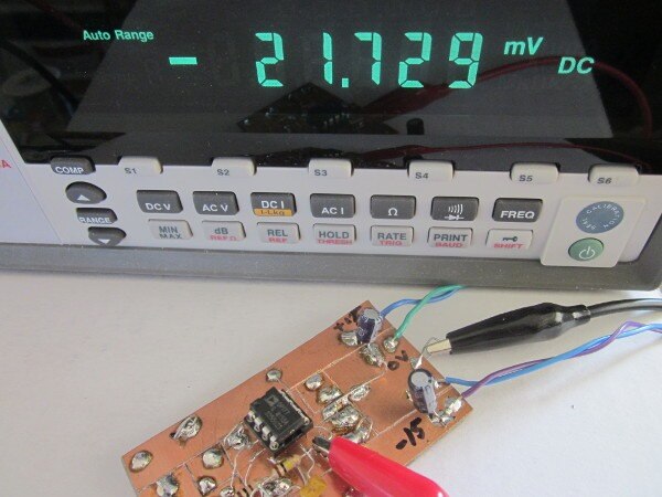

At that point I decided to change course and rewired the board like this
Now the op amp is simply amplifying the offset voltage and I can read it on a bench meter. Here
are the results for the same four op amps
TL081 FET-input bipolar. Typ: 3mV Max: 15mV Reads: 576uV
OP177 Precision bipolar. Typ: 20uV Max:60uV Reads 22uV
ICL7611 CMOS Typ: Not Given Max: 15mV Reads: 138uV (Iq was set to 1mA)
OP27 Precision bipolar. Typ: 30uV Max: 100uV Reads: 25uV
The reading on the meter is 1000 times the offset.
(More or less: strictly the gain is 1001, the resistors are only 5%, and there must be a small
contribution to drive the output to the measured voltage, though it won't be very much. So all in all
a little approximate, but good enough for a quick blog.)
The precision parts [OP27 and OP177] lived up to their billing, being close to their typical
figures. The FET-input TL081 was worst, but well within spec and better than might have been
expected [it has offset pins, so could be trimmed closer, though, with a lot of the
applications it gets used for, it wouldn't be an issue anyway]. The CMOS part was a lot better
than the datasheet allows for - so it looks like I got lucky with that one too.
