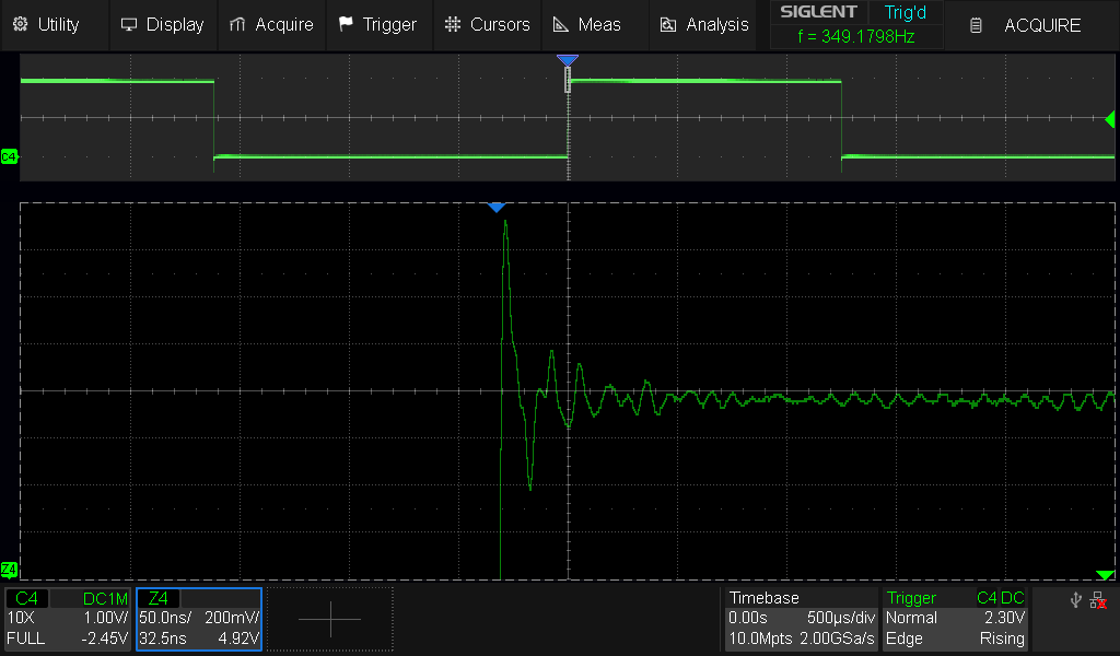

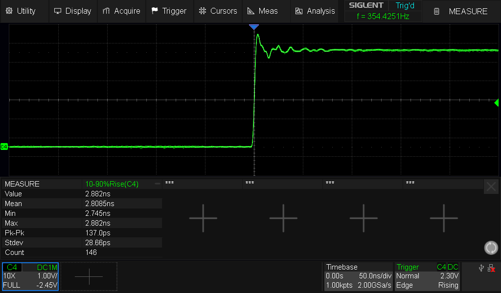

Today, I built a simple relaxation oscillator with the 74HC14 integrated circuit. The purpose of this circuit was to get a reasonably fast rising time pulse generator. Here is measurement from SDS824X HD:

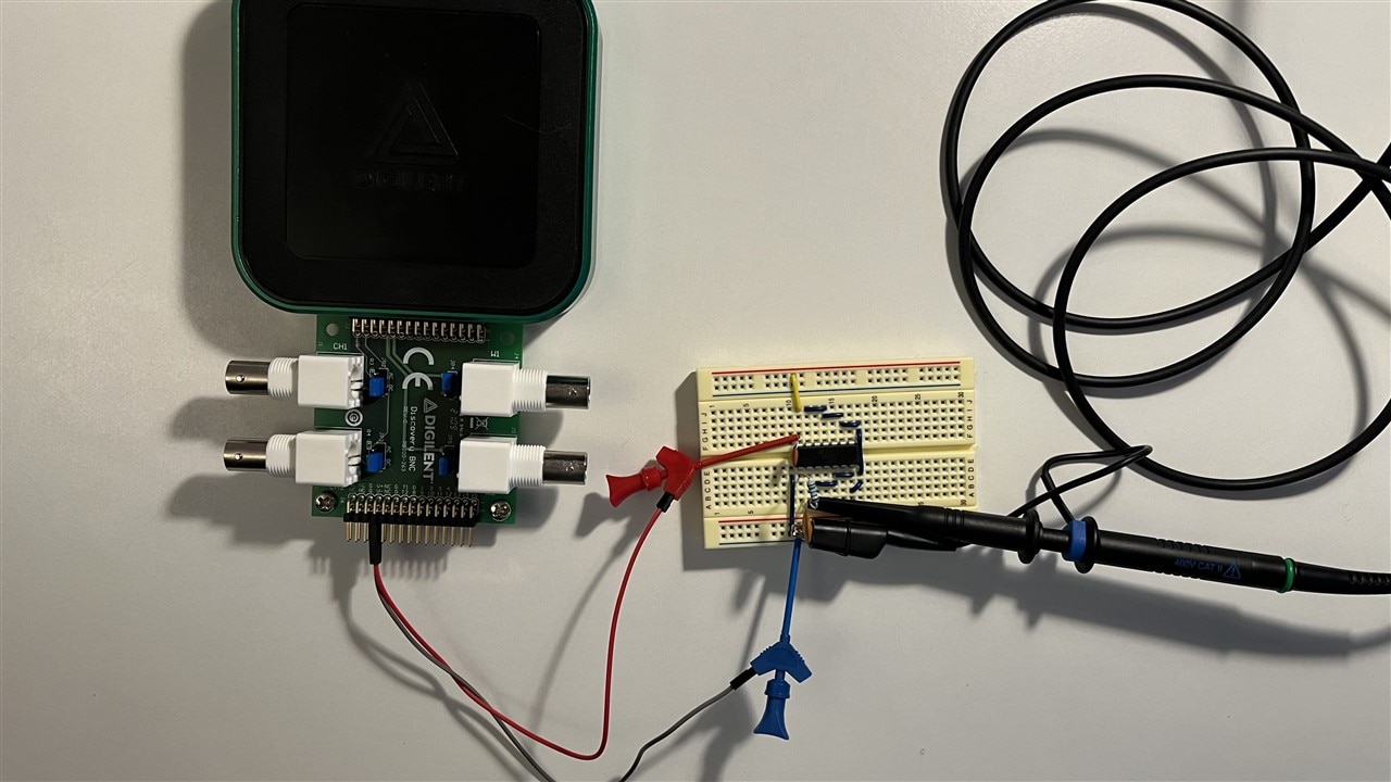

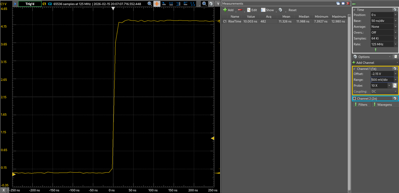

It is observable a noticeable ringing. For comparison similar measurement done by Analog Discovery 3:
Update 16.02.2026
I have created a soldered version of this circuit on a prototyping PCB and performed measurements again.
The first measurement was with an oscilloscope probe connected in the same way as in the case of the usage of a breadboard.
Still noticeable ringing is observable. So, I have performed once more measurement this time with the usage of a ground spring.
This time ringing is noticeably smaller. Measured mean rise time: 1.9179 ns is pretty close to this one provided by the manufacturer of the oscilloscope: 1.8 ns.
  • kk99
    kk99 9 months ago in reply to DAB +1
    I think that is due to the usage of a breadboard, which introduces parasitic capacitance and inductance. For example, with a series resistor at the output, the ringing was smaller, but this causes a slight…
  • kk99
    I think that is due to the usage of a breadboard, which introduces parasitic capacitance and inductance. For example, with a series resistor at the output, the ringing was smaller, but this causes a slight slowdown in edge speed. Probing should be better also (usage of ground spring or direct connection 50 Ohm) I think the best option is to use the PCB with possible short connections and a ground plane.
    DAB 9 months ago
    Nice post.
    Have you figured out the cause of the ringing?
