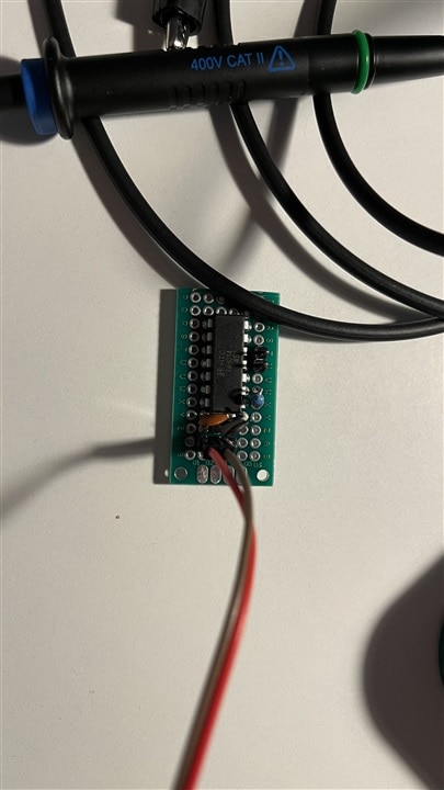

I have created a soldered version of this circuit on a prototyping PCB and performed measurements again.

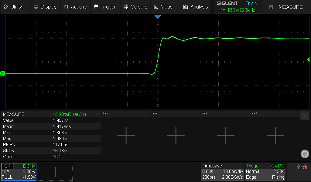

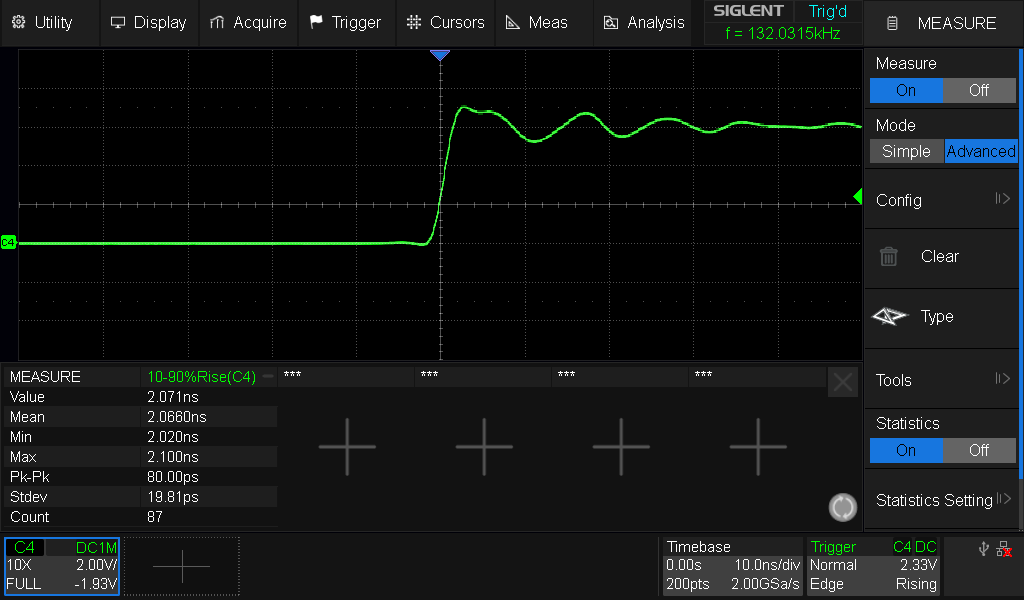

The first measurement was with an oscilloscope probe connected in the same way as in the case of the usage of a breadboard.

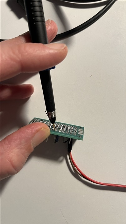

Still noticeable ringing is observable. So, I have performed once more measurement this time with the usage of a ground spring.
This time ringing is noticeably smaller. Measured mean rise time: 1.9179 ns is pretty close to this one provided by the manufacturer of the oscilloscope: 1.8 ns.

    kk99 9 months ago in reply to DAB
    I think that is due to the usage of a breadboard, which introduces parasitic capacitance and inductance. For example, with a series resistor at the output, the ringing was smaller, but this causes a slight slowdown in edge speed. Probing should be better also (usage of ground spring or direct connection 50 Ohm) I think the best option is to use the PCB with possible short connections and a ground plane.
