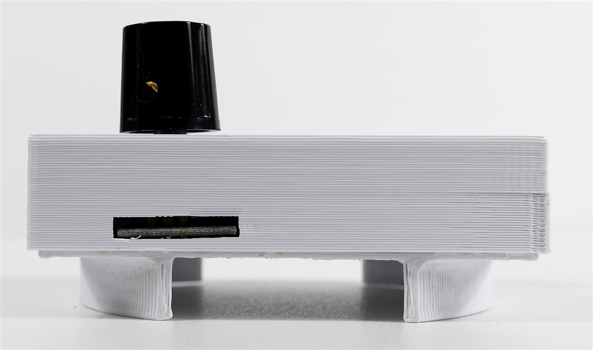

  • this view does not show any cables....Relaxed

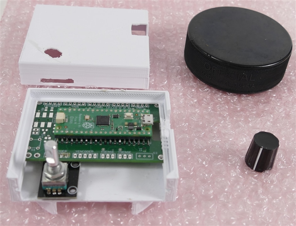

Okay - here is the exploded view....some of it should be quite recognizable...
Note how the main PCB slides into a slot making the set screw in the knob the only fastener in the system.

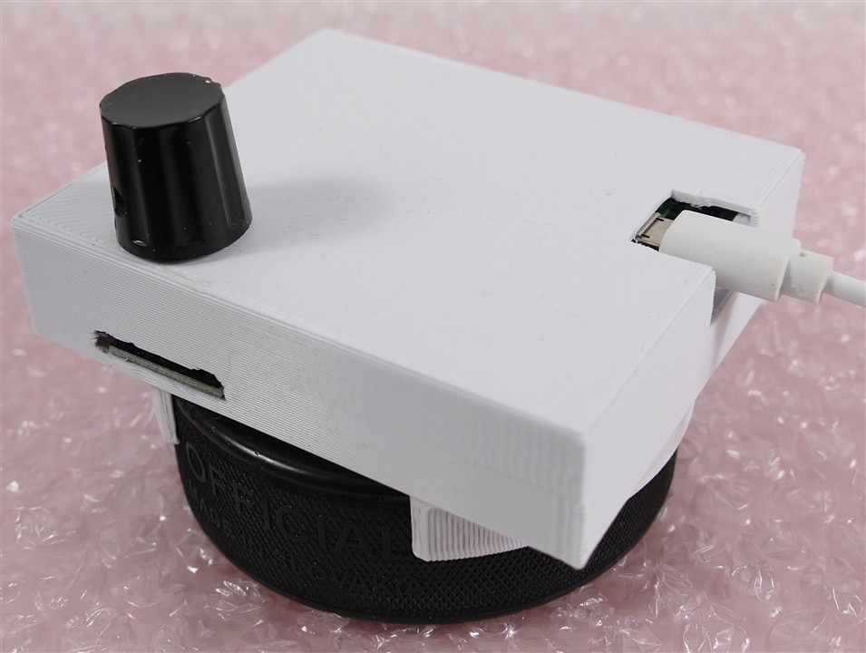

In the mean time - here is another picture of the assembled system....
