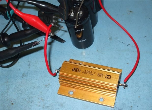

Following on from earlier discussions I thought I'd take a look at how easy (or not) it is to use a big MOSFET in a simple set up to switch a 5A load to test power supply transient response:
I used an STW60N10 MOSFET, a 3.3R load resistor, 4 x 4700 uF 100V caps in parallel. The MOSFET is driven from Rigol 1030Z signal generator set to make 20uS pulse at 100Hz rate. I tried it with and without a 100R resistor in the gate.
The power supply was 16.5V via  a100R resistor driving the capacitor bank.
Here's a picture:

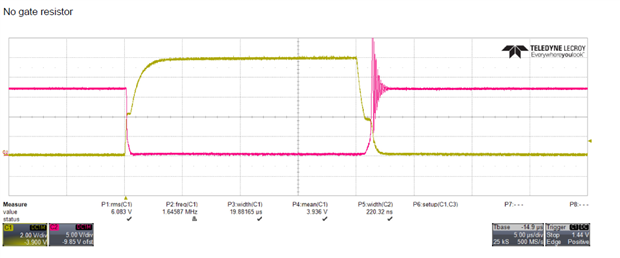

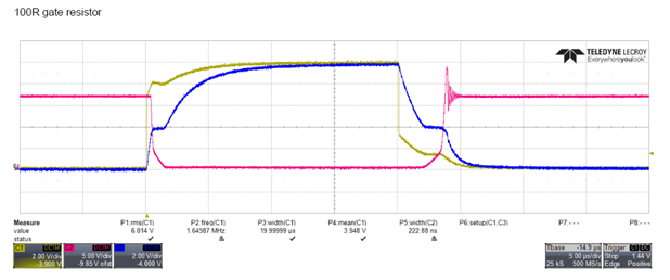

And these are the results:
Red trace is MOSFET drain voltage, Yellow trace is Sig gen output, Blue trace is MOSFET gate.
It's fairly horrible - the stray inductance in the load makes it ring when the MOSFET switches off and it turns out to be quite tricky to control this (using only passives and a sig gen for the drive pulses.)

    I tried putting small caps across the 18800uF main cap and it made almost no difference.
    So I added a snubbing network (22R and 47nF) and a current sense resistor (0.1R) and it doesn't look too bad now:
    The scaling for Is is 10A/V so the on current is very close to 5A.
    This is probably about as fast as these MOSFETS are going to switch without using high current drivers. Although I've labelled a trace as Vg it's actually the voltage on the signal generator side of the 100R gate resistor so the gate load of the MOSFET is quite large to distort the sig gen output so much.
