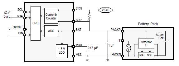

The new version of the Battery Chassis add-on for the Wio Terminal has added an On-Off button and a Texas Instrument's BQ27441 Battery Fuel Gauge https://wiki.seeedstudio.com/Wio-Terminal-Chassis-Battery(650mAh)/  .
The fuel gauge is a great feature that measures your battery's voltage to estimate its charge percentage and remaining capacity. The chip is also hooked up to a current-sensing resistor, which allows it to measure current and power.  The fuel gauge interfaces using I2C.  This will be useful to monitor the battery in remote datalogging applications.

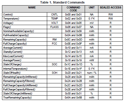

Here is a demo of Battery Status display on the Wio Terminal during discharging (running on battery power) and charging (running and charging from USB).  I haven't quite figured out "State of Health" yet - it always returns 0%.  And I'm not sure why the full battery capacity is incorrect (it should be 650 mAh).  I'll need to read through the BQ27441 spec.  And I also haven't been able to get the correct schematic for the new Battery Chassis, but I've requested it on the SEEED forum.

    Interesting device. The datasheet on the BQ27441 mentions a Coulomb counter, which would imply that the charge and discharge currents (mA) are being used to accumulate the charge over time (mAH) to determine…

    Ralph, I have looked through the datasheet and through the SparkFunBQ27441 library and I am completely confused. The library does not seem to match the datasheet. There is a lot to be confused about, as…

    Interesting device.  The datasheet on the BQ27441 mentions a Coulomb counter, which would imply that the charge and discharge currents (mA) are being used to accumulate the charge over time (mAH) to determine the actual battery charge state.  In a product that I worked on we did the same sort of process, with current and voltage monitoring, to drive a charge indicator (LEDs).  When properly calibrated we were able to get a pretty good readout of the remaining charge in the battery.
    TI has a white paper (slpy002) that describes in better detail their ImpedanceTrackTm algorithms, which appear to use Coulomb counting, impedance measurements, open-circuit battery voltages and various table to predict the battery charge level.  The Aging value seems to be based on long term changes in the measured capacities across multiple charge/discharge cycles, so you might have to wait a bit to see a change in that reading.

    I have looked through the datasheet and through the SparkFunBQ27441 library and I am completely confused.  The library does not seem to match the datasheet.  There is a lot to be confused about, as there are multiple 'Capacity' variables and given the offsets I see in the library it looks like they are setting the 'FullAvailableCapacity' as opposed to the 'DesignCapacity'.  Also in looking at their attempt to set the capacity, they seemed to be attempting to write to 'FullAvailableCapacity' without checking and/or setting the 'SEALED/UNSEALED' mode, which protects the 'FullAvailableCapacity' register.
    Some of this might explain why the 'StateOfHealth' is looking a bit off.  I don't know how deep you want to dive into this, but here is the technical reference document number (SLUUAC9A) that shows a lot more information on the internal registers of the BQ27441 device.
