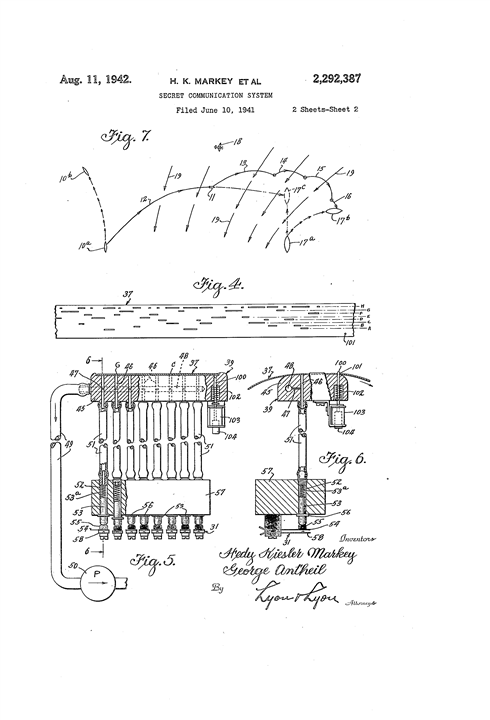

The musical concept was reimagined as a radio system featuring player-piano-style perforated paper records. Switches, which connected different tuning condensers to a variable frequency oscillator, were controlled by those record strips. Holes in the ribbon moved across a vacuum manifold, actuating rods that switched frequencies hundreds of times a minute. Identical rolls in the transmitter and receiver ensured both ends remained synchronized. In this system, the piano-player mechanism worked like a timing device. It determined when a frequency shifted so that both ends of the system remained synchronized.
Image showing U.S. patent 2,292,387 for the Secret Communication System developed by Hedy Lamarr and George Antheil. (Image Credit: Google Patents)
The project spurred a lot of interest, particularly with the National Inventors Council, to which the duo presented it. Both filed a patent application on June 10, 1941, and approval followed one year later as U.S. patent number 2,292,387 for this Secret Communication System. Lamarr recalled that both sat on her living room rug and used a silver matchbox and matches as a model for this idea to simulate the wiring. This allowed a receiver and transmitter to stay synchronized without a wired connection.
