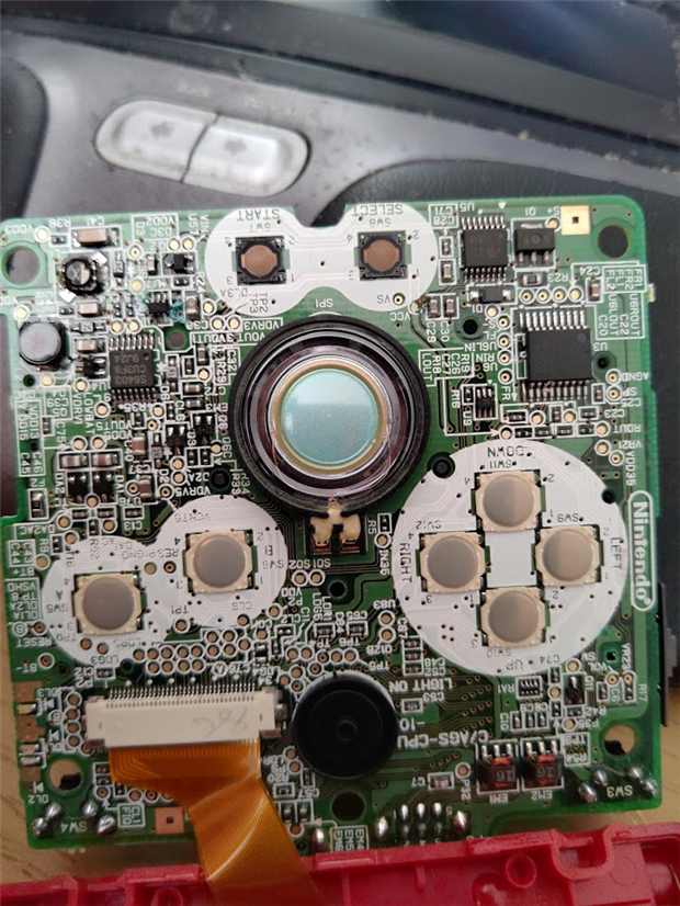

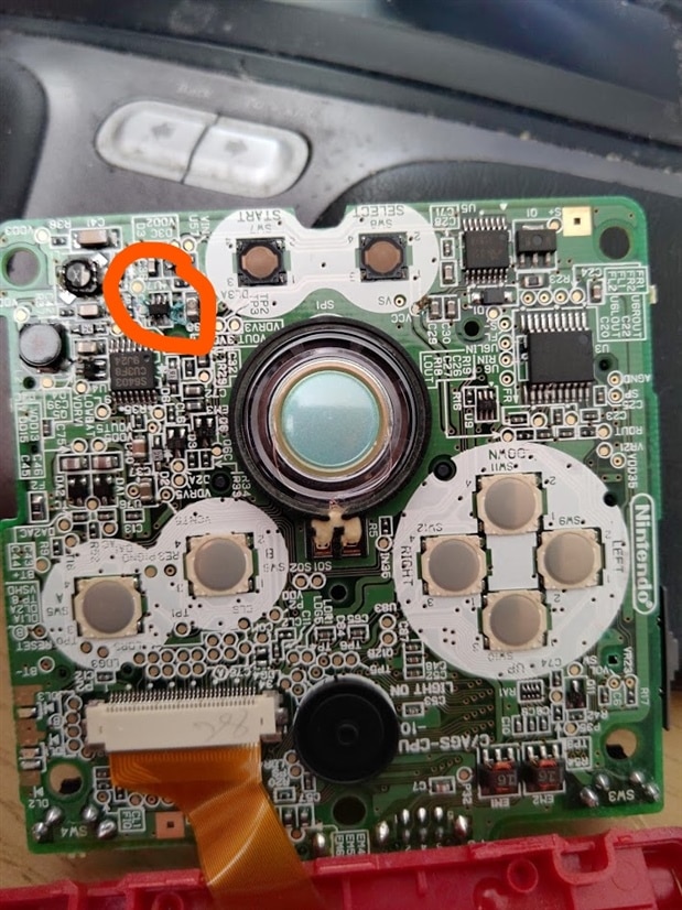

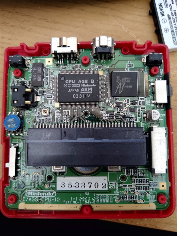

The GameBoy Advance SP works, however there's no audio from the speaker, the SP was different from the Advance in that there's no 3.5mm headphone jack either so I can't easily compare/check it.
What're the steps I can take to start diagnosing this and where the problem is? I'm not familiar with using an oscilloscope if necessary, though I have a bitscope one I could try to work out how to use. I'm not seeing any physical problems.

    Hi Christopher,
    It looks like U3 (near the directional pad) is the audio chip, but it's custom so no datasheet. However connections near it could be probed to spot the audio signal, but also worth checking supply rails (there may be a separate analogue and digital supply rail), perhaps identifiable by screenprinting on the board of test points or signal names, or if there is a ground plane. In any case, it appears to be the same chip as on the Gameboy Advance (non-SP), so the schematic will likely be very similar. This is the GBA schematic for that area, and the supply rails can be checked plus the audio at LIN, RIN and the SPKOUT pins. There's also pin 12 which is labelled STB with a bar on top, so that could be inverted standby, and would need to be high for the chip to be enabled.

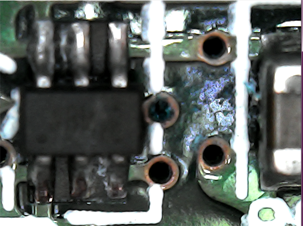

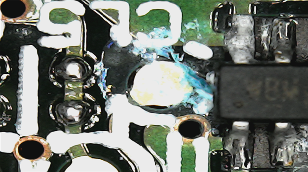

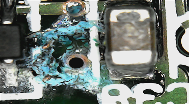

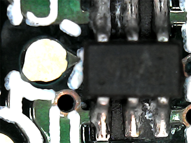

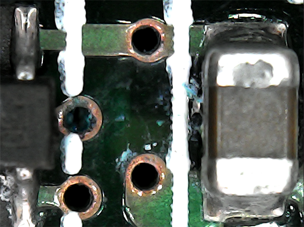

    The part that Matt identified as looking odd could be water damage, and might be power related (supply regulation or switching a power rail on or off) so could well be the cause too. It might need some some examination or solder re-melting there, if any corrosion has damaged a join or track. I couldn't find what part it was, I think it says WBM on the SOT23-6 shaped part U7, but my attempts to google for it found nothing : (

    Unfortunately the speaker is making good contact with the PCB.

  • msebok
    msebok over 6 years ago
    https://www.youtube.com/watch?v=iG-8Y6XKZzY
    this guy had the same issue.. found that the speaker when pushed against the contacts worked.. around the 6 minute mark
  • msebok
    Whats going on here? looks odd..
    shabaz over 6 years ago in reply to cstanton
    Oh, hoped it would have been an easy thing with some failed contacts : (
    The analogue channel on the bitscope could be used, by powering up the unit with a game installed and if it is known that sound should be playing for the game.
    The contacts near the volume slider would need to be probed (with the bitscope ground connection connected to the battery negative contact), and the 'scope set to approx. 1 msec/division or thereabouts, and 0.5 or 1 V/div. Also, probing near any small chip or capacitors that may be part of the audio amplifier circuitry, it could be physically between the speaker and the volume control area, just to spot if the audio signal is detected. There appear to be lots of 3-pin SOT-23 sized parts and some capacitors in that area from the photo, so that might be the amplifier. Probing on the capacitors would be worth trying, and if audio does get spotted in that area, then maybe reheating some of the parts there could fix it (in case a solder joint has lifted due to button-presses flexing the board maybe.

    Finally found batteries for my multimeter...
    7.6ohms across the speaker, appears to make good contact with the PCB (it's stuck to the board with weak glue and prongs make contact). No sound still.
    There's a volume slider, it has 6 solder points and those are very secure to the PCB.
    I don't have a crystal earpiece or another way of testing the speaker at the moment.
