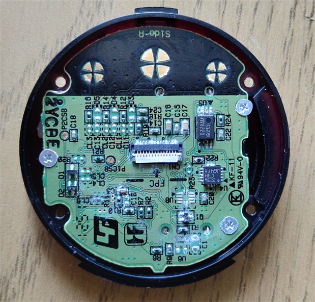

Unfortunately, despite my best efforts, somehow wearable electronics manage to find themselves in the washing machine. I wasn't even washing my trousers where I usually keep it, no, this time my Wii Fit U Meter found itself among the towels, and spun around in the machine. It wasn't until it was too late, and I saw its depressed features pushed up against the glass, that I realised it had gone through an exciting event and probably inflated my walking score.
I didn't try to power it on. Not able to find my Y screwdriver, the only thing I could do was put it in rice.
The rice got damp very quickly after a day on the window sill in 35 degrees C heat, I replaced it a couple of times, found my Y screwdriver and finally took it apart.
I have some cleaning to do, now, what's the best way to clean this?

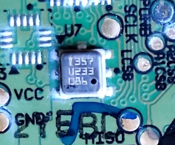

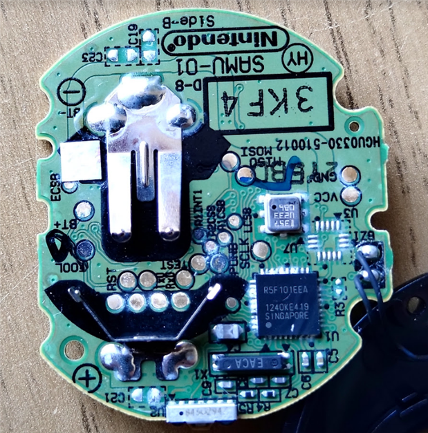

I also couldn't help but notice a number of test pads, and some that may even be programming pads.
    Jan Cumps over 6 years ago in reply to cstanton
    It's a Bosch BMP183: https://www.adafruit.com/product/1900
    SPI version (180 is i2c) - unobtainium

    The numbering and look  is consistent with Bosh altitude/barometer sensors ( like BMP180)

    Yeah the altimeter/barometer with temperature sensor in this device appears to be shot/has suffered. It's not returning to life.
    I'm wondering if I can find a replacement part for it and do a bit of reflow, I'm going to assume it's this part:
    I should probably take a better photograph with my microscope.

    Isopropanol and q-tips (thanks dougw ) has been the way to go! It's all cleaned and powered on, it's pretty resilient.

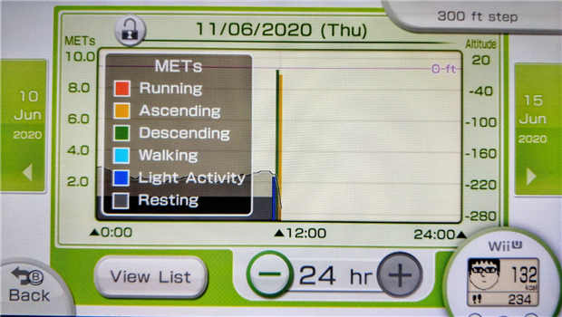

    Sadly though, the pressure sensor in it appears to have failed (it uses the barometer to measure height so it knows when you're climbing or using stairs).
