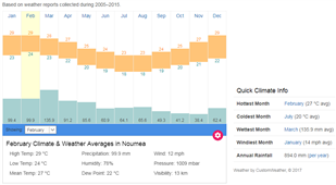

New Caledonia has an interesting climate, being south of the equator and near Australia should give you some idea of the type of tropical environment which Cresties live in naturally. It is a place of high humidity, temperatures up to 29 degrees centigrade, and as low as 16 degrees centigrade, depending on the time of day, the time of year, and whether or not you are in a cool breeze and in the shade.
It is this kind of environment which we need to recreate in a vivarium to keep the Crestie happy, so that it is able to clean itself, keep hydrated and to shed its skin when necessary.

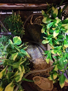

Every time Bernie is let out of the vivarium she goes for a wander up and around it, and (yes the power is disconnected) she enjoys crawling through the wires up against the ArduinoArduino that I currently have setup for the start of the monitoring and control project, we think that she would probably enjoy some more vines inside the vivarium as she also love to crawl into/up hair as well.image

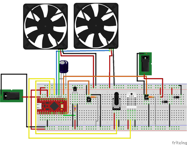

So the plan, use an Arduino, or a couple of them, to control fans which would help to ventilate and also cool the vivarium when needed, it would decide when to do so by monitoring the temperature with DS18B20DS18B20s and react to temperatures outside of the desired parameters as appropriate.

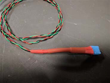

The next stage of this development would be to also control the misting system. This would be governed by a sensor, which at present is a DHT11, which is attached to the Arduino to detect the humidity level for when it gets too low, I considered misting the vivarium on a timer also, however this was attempted before all of the electronics and the tank was almost flooded (note to self, consider drainage for the vivarium tank). So, a humidity sensor and some intelligence on the actions is better. Since the Arduino can run from 12 volts from the VIN/RAW thanks to its onboard voltage regulator, I can power the fans, the misting system, and use mosfets between the logic input/output pins and the power for the water pump, while also using the 5v sensors. The fans would have to use pulse width modulation (PWM), using typical 120 millimetre fans designed for cooling a computer case works perfectly for this and happens to be the right size for the top of the vivarium, I could even monitor the speed of them as well, and use a potentiometer as a manual over-ride to control the speed if I didn't want to rely on the automatic logic coded into the chip. In fact, here's a handy fritzing:
The barrel jack on the left is the 12 volt in, while the barrel jack on the top right is to the misting pump/system, as it is purely a water pump in a box, connected up to a wall wart.
I was surprised to discover that Fritzing was a pain to use. Especially if you want to use parts that do not already exist in its parts library and forcing you to create new parts. To do so you can't create a new one from scratch, you have to repurpose an existing one and edit it. Trying to create a printed circuit board layout from your breadboard designs is even more annoying, to me at least. Fritzing kept crashing when trying to perform its autorouting and lost the circuit components. Good thing I had a backup.
As an extension to this design though, I could also take over the control of the heating elements from the thermostat that's currently in use. I would have to add additional circuitry to make it aware of the time of day and to maintain this without slipping out of synchronisation with real-time, though the current thermostat has been running for so long, reliably, it is a sufficient constant that I can rely on it to maintain heat.

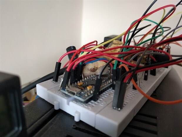

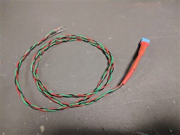

It's also worth noting that these components are not all sat on the breadboard like in the fritzing diagram, in fact, I had to find a way to encapsulate the DHT11 humidity sensor so that I could put it into the vivarium safely. So, enter an amount of overlapped heatshrink and a bit of well enveloped hot glue, and also practicing something I have never done, braiding:
I'm sufficiently pleased with how they turned out, and it's not the type of thing which Bernie will try to eat on, unless it moves in the dark. She'll probably use it to shed against if anything. The DS18B20 is similarly protected (though I bought it like this rather than making it up myself) :imageimage

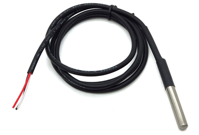

Fritzing aside, the Arduino IDE steps up for programming the device and using the OneWire example as the basis, we have a very rudimentary program that can monitor the temperature input from the DS18B20 and output the PWM signal required to control the fans, here is a snapshot of the code from my github repo:

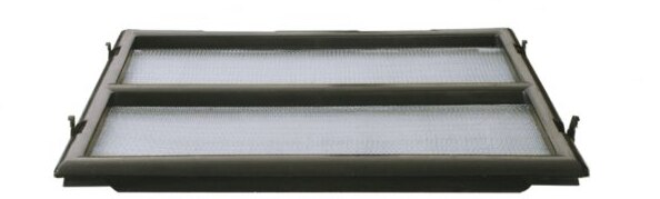

At the top of the vivarium there is a removable panel which has a metallic mesh to allow heat and airflow. This is perfectly designed for the "Exo Terra" range of vivarium additions such as the heating lamp we currently have covering half of the panel. The other side was available and happened to be perfectly sized at approximately 240 millimetre by 120 millimetre, so two fans it is!image
The fans have three connections, power, ground and signal, and most importantly they operate at 12 volts. Aside from the signal connection, which offers up the speed of the fan using PWM and I believe has a built in resistor on the fan to provide this at 5 volts.
The arduino however, operates at 5 volts logic, and will happily take 12 volts. So this meant I needed a way to control the fans via PWM at a voltage which the Arduino was happy at. There are some examples out there where you can solely use a 10kohm resistor connected to the power lines of the fans to control the speed. However I didn't want to do this (because learning), there are sensible reasons why not to, part of my concern for example, are power spikes that usually happen from turning motors on and off (diodes can also help with this). Relays are sometimes peoples choice, but they are too slow for PWM, they really don't like being switched on and off quickly. So my choice in this matter was the MOSFET.
The circuit for the MOSFET is relatively simple. I connected the 12v line to the Arduino and also to the 'positive' of the 120mm fans, and the 'negative' (ground) to one side of hte MOSFET. The other side of the ground is connected to the ground/GND of the Arduino. The third, centre leg of the MOSFET, utilising a pull down resistor (to prevent it floating if nothing else) is connected to an input/output logic pin on the Arduino, and it's this PWM pin which controls the fan's speed and overall provides enough protection to not set fire to the Arduino.
I haven't worked out the code properly to read the fan speed signal from the fans, though. I think I haven't quite got the synchronisation or the maths correct to make sense of the signal coming from the fans. It's important to have this feedback though to ensure that the fans are working, and to be able to alert if there's a problem with them.
I did consider having variable fan speeds, that would scale with the temperature detected, so that at lower temperatures there was still some airflow happening, and when it was getting too hot we put the fans at full speed to "yep, this needs cooling down, right now". The code for this was bad, and it was lagging the microcontroller so that the reaction time from temperature to fan speed was ever increasing (this is not a good idea). I will need to refactor the code so that it is interrupt based, and I changed the code so that it merely goes "okay, we're too hot now, turn the fans on max and cool down as quickly as possible", this has in truth worked reasonably well. So I'm not sure of the merit of the other method, aside from prevention of it getting to the 'it's too hot and we've made sure it doesn't get that high at all'. So I may reconsider it.
There is also some concept of circuit protection in the design, you see, when you're controlling motors and they're spinning up/down, you may be pushing electricity to them, however motors are also like miniature generators that can create some power themselves, and this power is known to spike higher in voltage than what they're rated at. So, to protect against this, we put diodes in the circuit to prevent the spikes from going back to the controller circuitry, and instead force it to run across the motor again. Which is somewhat safer.image
