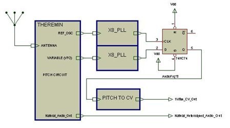

This article discusses the applications I was working on regarding:
1) Generating, from theremin frequency difference (audio* output), a 1V/Octave control voltage for controlling both internal synthesis circuits and driving external voltage controlled synthesisers and modules, and
2) Converting heterodyning theremins so that they could be controlled by a 1V/Octave control voltage.

The difference is that, prior to obtaining audio from mixing the two HF waveforms, you have these two HF waveforms which have a difference frequency that gives (after mixing) the audio – and this fact makes it possible to obtain the audio* frequency multiplied by whatever one wants, and thereby reducing latency and eliminating other problems – This can only be done with theremins!

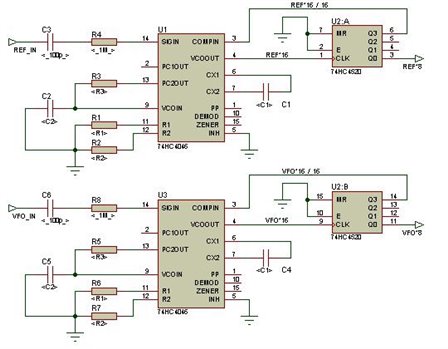

The PLL, in its simplest implementation, is capable of multiplying an input frequency by some integer constant. Design of PLL circuits / systems can be horrendously complex if they are required to track wide ranging frequencies and stay in ‘lock’, but for use in multiplying the reference and variable oscillator frequencies from a theremin, they are nearly as simple to use as a 555 timer!
What is required is to multiply the frequencies of BOTH the reference and variable oscillators, and obtain the difference frequency AFTER these have been multiplied – doing this, one ends up the difference frequency being multiplied by the same constant.

Lets take an example where the reference oscillator is running at 250kHz, and the variable oscillator has a 5kHz span, giving an audio output from null point (0Hz) to 5kHz.
We want (say) to have our CV track from 16Hz to the maximum 5kHz, and the minimum frequency our pitch-voltage converter (which requires 2 cycles to acquire the voltage) can accept is 100Hz, we can calculate:
Difference frequency before multiplication = 16 Hz
Required multiplier (for both Ref and VFO)  = 8,
Reference frequency before multiplication = 250kHz
Reference frequency after multiplication = 2000k = 2MHz
VFO (variable oscillator) frequency before multiplication = 250kHz – 16Hz = 249.984kHz
VFO (variable oscillator) frequency after multiplication = 1999.872k = 1.999872MHz
Difference frequency of multiplied oscillators = 128 Hz.
If our difference frequency was 5kHz, and we stayed with a multiplier of 8, the reference oscillator frequencies stay the same, but VFO and difference frequencies become:
Difference frequency before multiplication = 5 kHz
VFO (variable oscillator) frequency before multiplication = 250 kHz – 5 kHz = 245 kHz
VFO (variable oscillator) frequency after multiplication = 1960.0 kHz = 1.96 MHz
Difference frequency of multiplied oscillators = 0.04 MHz = 40 kHz
It can be seen that:
The VFO PLL only needs to track a tiny deviation from its centre frequency (input frequency varies from 245 kHz to 250 kHz for a theremin having a 5kHz span, and the PLL could deal with a much greater frequency deviation, easily 10% or 25 kHz)
The frequency range fed to the pitch-voltage converter has been raised (multiplied) – this converter would need to be modified or re-designed to cater for the higher input frequencies.
The 16Hz frequency (theremin audio) can be resolved into a voltage in < 16ms if 2 complete (multiplied) audio cycles are used – but, in fact, this time can be at least halved if the PLL/ divider outputs a square wave with equal mark and space times, as all the required information is then contained in one ½ cycle.
Combining the above facts, it is possible to design the PLL so that the frequency presented to the pitch-voltage circuit can be reduced by one octave and the P-V circuit designed to work on half cycles.
