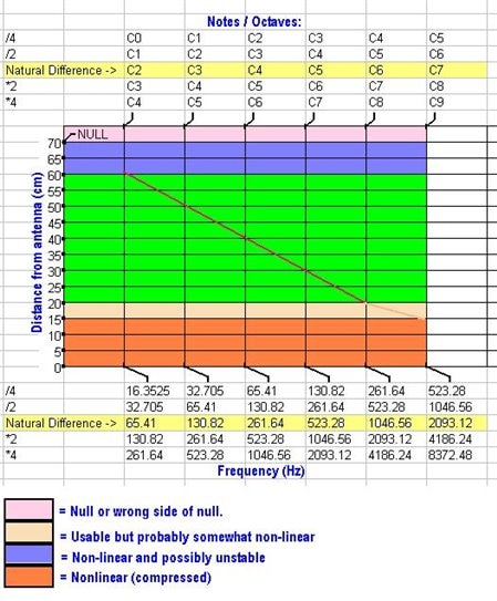

Why a Register Switching Theremin?
If one wants to play more linear octaves with reasonable spacing between notes, a register switching theremin can allow you to do this – One can play about 4 octaves in a ‘perfectly’ linear area of the pitch field, and  about another octave where the field may be somewhat distorted, and you can switch the registers so that the linear field is covering the registers you are playing.
The other factor is technical – It is extremely difficult to design, build and TUNE a theremin to give linearity over a length of (say) 70cm, and to compress 9 octaves into this field, even if equally spaced one would have quite a tight squeeze on notes. By switching registers, one makes it possible to utilize the linearity which is not too difficult to obtain, and to extend the note coverage without causing field compression.
The diagram below shows one of my Plasma breadboards response plots – this particular variant used oscillators based on the Silicon Chip / EPE designs, heavily modified – I was not happy with the stability of these oscillators, and use with a linearizing inductor (which produced these results) was highly unstable – Replacing these oscillators with better ones based on the EW gave much better results:
The S/C oscillators ran at ~ 460kHz , and they could have been divided down again to give coverage from 8Hz to 261Hz – with this (/8) divisor, the HF oscillators would have been divided down to 57.5 kHz, so the high frequency components could still be filtered away easily after heterodyning. There is a limit, however, on how many stages of division one can insert before one has problems cleaning up the heterodyned waveform.
Using oscillators running at ~ 250 kHz, I limited Plasma to /4, this gave plenty of headroom to for the filter (lowest unwanted frequency to be filtered is higher than 50 kHz).

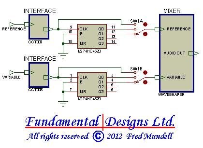

One can build a simple version of Plasma which does not use PLL’s and only has 3 ranges – the /4, /2, and ‘natural’ (/1).
In the following diagram/s, I show switches – this is just for speed and clarity – As everything is at logic level (I used 74HC family running at 5V, and PSoC running at 5V) one uses programmable dividers or data selectors to facilitate the “switching”.

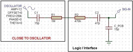

You need to ‘isolate’ your oscillators from your logic – and you need to produce clean logic level square waves of the oscillator signals.. It is imperative that the interface / logic does not load the oscillators in any unacceptable way, as in, resistive load must be high, and capacitive load must be extremely low and unchanging. Depending on which oscillators or circuitry you are interfacing with, different techniques will need to be employed, but whatever oscillator you use, this interface needs to be carefully thought about!
- Interfacing to the SC/EPE designs is simple, as most of these are buffered. See my >>Skywave H1<< where I use a LM393 comparator, as an example.

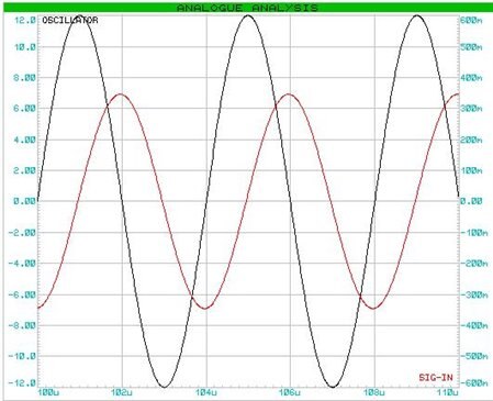

- Interfacing to the Moog EW oscillators should be reasonably simple – when I interfaced to them I used the SIG-IN pin of the 74HC4046 PLL, this pin accepts AC coupling and has a self-biasing input amplifier – The voltage from the EW oscillators is high (+/- 12V) so the signal level needs attenuating – this allows one to use the pin capacitance of the 4046 and board (about 10pF) and resistance between the oscillator and this pin to provide the attenuation.. I connected a 22p capacitor to the oscillator, this connected in series with a 1M resistor, and these components were mounted right at the oscillator.. I then ran a wire to my logic board which had a 470k resistor in series with a 22p capacitor which was connected to the SIG-IN pin. Prior to connecting to the SIG-IN pin, I tested the signal with my ‘scope (you cannot reliably probe the SIG-IN pin with a scope, as the probes capacitance is usually higher than the pin capacitance and additive) and had a signal level of 350mV. The SIG-IN pin requires 300mV, so this was in the right ball-park, and it worked.
The best bet is to buffer the oscillator signals with a voltage follower (BJT or FET) – But direct interfacing to a comparator in a similar way as I described for the HC4046 should be fine – giving the comparator some hysteresis is also a good idea.
This is shown in the simulation below:
And this is the block diagram – Circuits for the interface have been discussed above, circuit for the mixer / waveshaper are given Here, all you need to add are the audio processing (minimum an adjustable LPF) and volume control antenna and VCA.

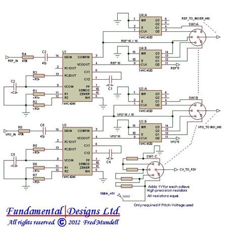

    This schematic shows the full implementation sheme for 5 register ranges, using PLL's

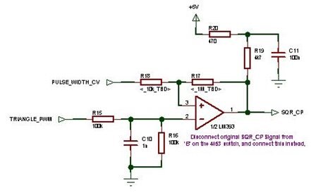

    Mention is made of pulse-width adjustment for the square wave, but this is not given in the schematic.
    The basic scheme is this:
