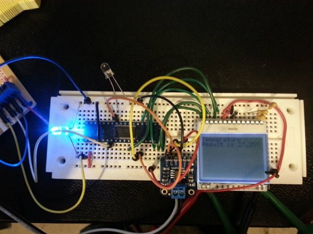

    joe over 12 years ago
    Here's a picture of what I have wired up so far.  The MSP430G2955 is a 38 pin TSSOP package device and is attached to an adapter board for easier prototyping.  I also used the Thermocouple Amplifier MAX31855 breakout board from adafruit, to let it do the math calculations for me.  When connected to a Type-K thermocouple, it provides the temperature result to an accuracy of 0.25 degrees Celsius and sends the data out by SPI so that it can be read in by the microcontroller.  I'll include more details in the future about the data format and the code I used to parse out the temperature result.
    Type K Thermocouple: Thermocouple
    adafruit Breakout Board:Thermocouple Amplifier MAX31855 breakout board (MAX6675 upgrade) [v2.0] ID: 269 - $14.95 : Adafruit Industries, Unique &…
    MAX31855 Datasheet: http://datasheets.maximintegrated.com/en/ds/MAX31855.pdf
