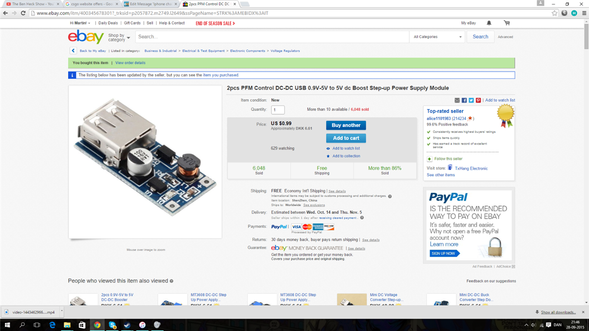

Hello, my name is Martin
I have a very big problem with a 5v usb boost circuit. When i connect the circuit to the power, the led lights up, but no power... to iphones... everything else works, just not iphones. i already tried shorting the data ports with the 5v pin, AND THAT USED TO WORK, but not now!!!??
PLEASE HELP
I have now tried with adding some resistors to data+ and minus, still nothing image
HELP!!!

    The resistors connect to the USB D+ and D- lines and to the 5V and 0V connections. In the link that Petri showed, the USB connector is shown on the right (i.e. corresponds to the USB connector on your board), and the two center pins there are designated USB D+ and D-. The top wire connection in that diagram is +5V and the bottom wire is 0V.
    Google may have some better annotated diagrams, but the connections will be similar. Without the resistors, expect it not to work or to charge slowly.

    Thanks for the answers btw, but now i need more xD, while waiting for the resistors i tried shorting the data+ and data- just by connecting the two, and the phone charged! but... not really, since the icon was there, but the percentage wasnt going up, but down xD, is this because of the resistors i need? and also, what part of the 5v boost converter do i connect my resistors to? the regulator? capacitor (assuming that's the round black thing)? xD

    Exactly. iphone charges only when d+ and d- are pulled to about 2.7v. I cannot exactly remember if those voltages are absolutely correct.
    Normal USB charger just won't work for that reason.
    0 e14 Contributor over 11 years ago in reply to e14 Contributor
    Im not sure if i understood correctly. This picture shows the device i have, and what you're telling me, is that somewhere, i have to add 4 resistors?image

    You need to make a resistor dividers to both D+ and D- lines: http://cdn.instructables.com/FOF/IG95/GTLRHJWG/FOFIG95GTLRHJWG.LARGE.jpg
