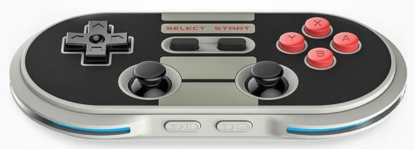

    Okay, I think I've found it. I know this isn't exactly what you're wanting to do, but I think it might be your best option for swapping out the awful RetroN wireless controller with something better.
    A company called 8BitDo makes retro-styled wireless controllers for iOS and Android (primarily, but they're bluetooth -- you can use them for pretty much anything). A little while ago they released a variation on the controllers' firmware, that makes then compatible with the RetroN5.
    From what I've read, it can be a bit of a headache getting them set up, and you have to install new firmware on the controller itself before it'll work, but these are seriously nice devices! I like the NES30 Pro, especially:
    Here's a bit more reading on the subject of updating the firmware for these controllers, in case that's a route you think you might try. Keep us posted!
