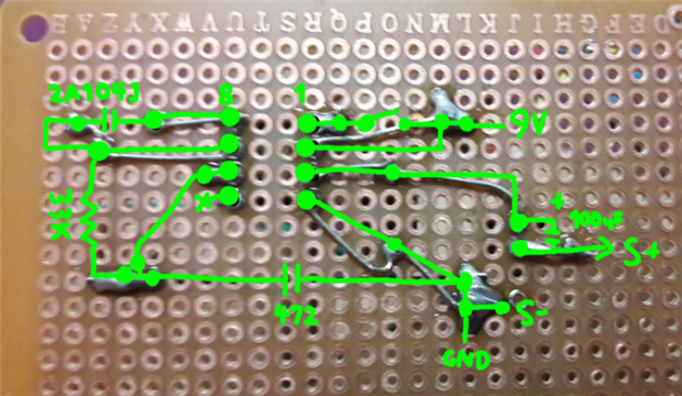

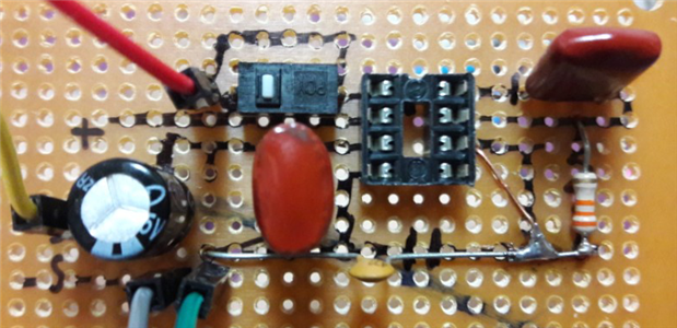

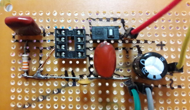

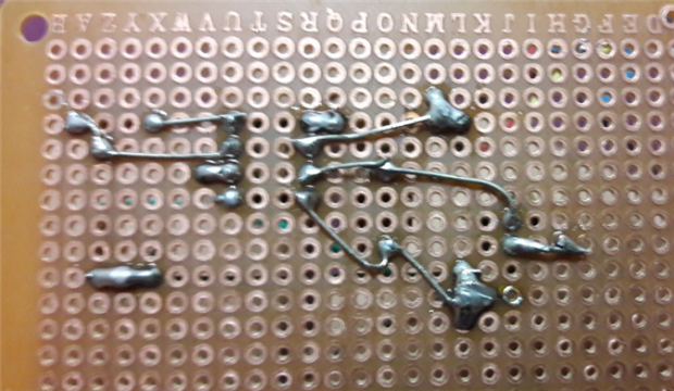

Hello people, I need some help with this issue.
(The chip that was supposed to be in the socket is SAB0600, from Siemens.)
I assembled the circuit "textbook style", EXACTLY replicating the circuit shown in the datasheet.
Circuit both assembled as-is on both breadboard and perfboard.
But it doesn't produce any sound when the switch is engaged (it should produce three chimes)
On breadboard, the circuit did make DC clicking noise when 100 microfarad capacitor was inserted backwards.
I do not have a multimeter yet that could reliably check the voltage, but using a trusted 5V power source and tuned analog multimeter, I verified that the power supply is outputting 9V, which is in-spec.
All chips bought from eBay, none of them came in static-safe packaging, not even the pink foam.
I had one sound chip that was not working and UM3482A Melody IC that didn't emit literally ANY noise even with all the components in the right place.
Am I crazy and killed all the chips, or am I stupid and I did something wrong, or was the chip faulty?
Any help is greatly appreciated, please tell me your opinions.
(Image mirrored to provide visual aid)
Sorry for the drunken soldering job, I still have problems with my hands.

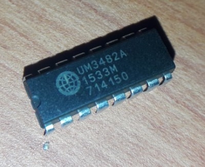

    0 pathfider1998 over 8 years ago in reply to shabaz
    It does have some questionable markings, as shown in the picture:
    The chip has lasered on markings and has no date codes.
    The chip has what looks like sloppily written letter "F" on it, shown here:
    The top stroke goes all over the place.
    The legs have some suspicious scores on it too.
    Also, the other chip is COB with small circuit board, and UM3482A chip is shown below:
    0 shabaz over 8 years ago in reply to pathfider1998
    Hi Phil,
    I can't be sure but it it likely a fake since there seem to be several suspicious things about it as you say.
    I'm not sure on the UM.. chip, that may be fine, a lot of these types of ICs were sold for COB applications for greetings cards etc., as well as the DIP package.

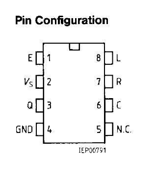

    0 niteowl12 over 8 years ago
    Phil,
    Looks like you have the pinout mirrored on the perf board.
    SAB0600 Datasheet(PDF) - Siemens Semiconductor Group
  • pathfider1998
    0 pathfider1998 over 8 years ago in reply to niteowl12
    The image is mirrored as previously mentioned.

    0 niteowl12 over 8 years ago in reply to pathfider1998
    Oops, missed that part.  Check page 8 in the datasheet, Figure 5 shows a circuit for a battery driven circuit and there is a note that says a capacitor is absolutely necessary for battery operation. Maybe try putting another 100uF across the battery terminals as a quick check. I also noticed there is another capacitor that is missing from pin 3 to ground. Maybe add the two and try before going through the return hassle. Worst case is it still doesnt work.
    (EDIT):
    Realized you mentioned power supply but the capacitors still should be there for some filtering.  Found this for you though, looks to be the newer version. The only problem is that the DIP package doesnt have any available but the 8-SOIC does.
