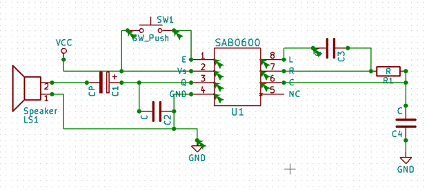

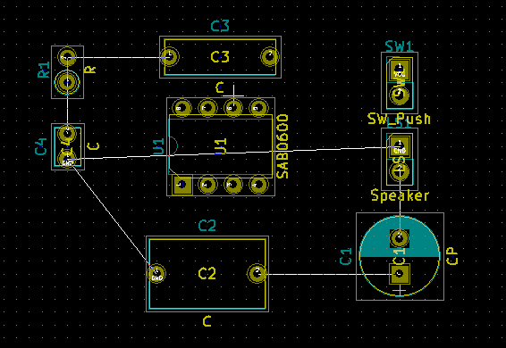

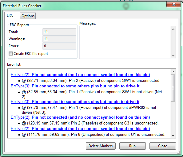

A little bit of story behind this:
So, since I had to make a custom part because this is an obsolete/obscure part on KiCad for my project.
But when I made it, literally every pin began throwing ERC errors, and netlist is all borked up, causing some pins to lose the connection and throw ErrorType 4 fault.
Below is a bunch of screen capture of the problem.
Attached is the entire project folder zipped, use it to diagnose what went wrong if needed.

    0 jadew over 9 years ago
    The footprint for the IC seems wrong.
    The pins seem to be flipped. The label should be inside the package, not outside, which means that you're not connecting those wires to anything (they just seem to be connected).
