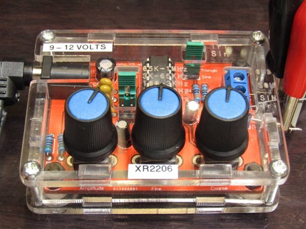

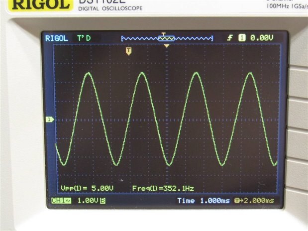

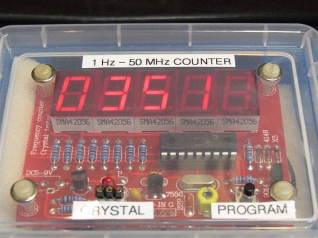

    0 jw0752 over 8 years ago
    Hi Oguz,
    Here is another option.
    https://www.banggood.com/XR2206-Function-Signal-Generator-DIY-Kit-Sine-Triangle-Square-Output-1HZ-1MHZ-p-1206339.html?rmmds=search&cur_warehouse=USA
    This kit is available for about $6.50 from China and will generate square, triangle, and sine waves from less than 1 cps up to 1 MHz. I set one up and ran 12 volts into it and I was able to generate 350 Hz at 5 V P-P. It was generally stable within two cps and .05 Volts. When you are done with your project you can use it as a simple signal generator. Here are some pictures of my test.

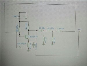

    0 Jan Cumps over 8 years ago in reply to alienozi
    alienozi  wrote:
    Thanks, John
    We are trying to obtain a sine wave of 350 Hz at a Pk-Pk Voltage of 5V. Output must be continuous (or a good enough one).
    I do have an oscilloscope, a Tektronix TDS 2002.
    Here are the circuits we've worked on so far: (sorry for the quality of the pics and circuits )
    Traditionally, the feedback+phaseshift network is drawn in front of the transistor.
    Because it's a feed-back network, and by putting it in front of the amplifier, it shows that the signal is feeding back image.
    That's all.

    0 michaelkellett over 8 years ago in reply to alienozi
    Measure the DC voltages on the transistor base, emitter and collector and tell us about them - this circuit CAN work.
    It's a really good exercise to work out in advance what you expect the voltages to be.

    0 alienozi over 8 years ago in reply to michaelkellett
    Well, Michael, the circuit is not functional in real life. I dunno how it happens... Anyways thanks for your time!
  • michaelkellett
    Well in that case you should be OK with this circuit - it can't drive much of a load (certainly can't drive a loudspeaker) so you'll need a power amplifier, but it'll be fine for being  a noise.

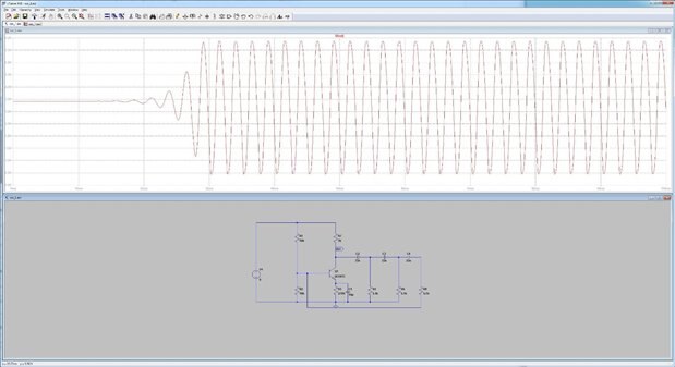

  • michaelkellett
    Ok, this is your circuit simulated in LTSpice - where's the problem ?
    It's called a phase shift oscillator and because this implementation has no sensible control of the feedback it will either not oscillate at all (R6 too high) or be distorted (R6 too low).
    This circuit is very independent of transistor parameters.
    if you need low distortion there are better circuits.
    What are trying to do (ie give us the big picture, like "scare dogs" or "make a noise").
    Is it a school project or task ?
    MK
