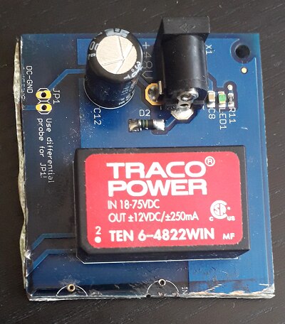

So I'm wondering if I could feed the 15V supply into a 12V regulator and subsequently a 5V regulator for Side B (I need 12V and 5V on that side) and into a 12V DC-DC isolator that outputs 5V for side A which also powers the Arduino.
Something like this Tracopower supply.  When I look at this I see that the Vin ground is connected on Side B, but the Vout -Ve is isolated for Side A so it seems like it would do the trick.  I thought I'd ask here first before committing to spending money to try it out or indeed if there were other ideas.

    Hi Andrew, Yes this is an isolated DC to DC converter and it will provide a voltage that is not common to the input voltage. this should allow you to do what you are talking about though I am not weighing…
    jw0752 over 5 years ago in reply to Jan Cumps +3 suggested
    Hi Jan, I believe there were two models listed on the data sheet. One had +/- with a common and the other was just +/- with no common. If I read it correctly both of these options were isolated from the…
    Jan Cumps over 5 years ago in reply to Andrew J +3 suggested
    If you need single output, you're good. The output is isolated. If you want me to pre-check something, I have one of the same family;

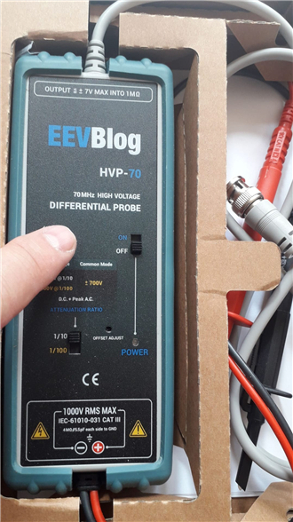

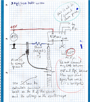

    By coincidence, today, balearicdynamics and I had a chat on preventing this image
    When I use my scope to measure situations where I want to put the probe reference on a different point than Ground, I use this:
    They aren't cheap - I believe that Gough Lui has found a good cheaper one, if I recall correctly.
    On the other hand, they prevent damage to your scope or device under test when you need to probe without ground reference - or without short-cutting a circuit node to ground if you accidentally put your crocodile clip on a non-ground node.

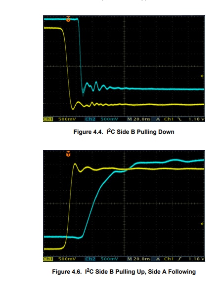

    I didn't fully understand the requirement and the both sides sharing power or ground portion, but for I2C isolation, what you're showing looks good, I think there's no way around it, I2C isolation methods need to do tricks to detect which side is driving the bus, so slightly different voltage levels are often used for that inside the ICs.
    Although I've done logic level translation for I2C using a similar method (just with a non-isolating chip), for isolation I've avoided it (no real reason, just for simpler logic levels), and taken the easier option of SPI parts where isolation is needed, and then the circuitry uses more basic isolator chips that don't need to detect which side is driving. If it had to be I2C then I'd use the same or similar parts as you.
    0 Jan Cumps over 5 years ago in reply to shabaz
    That was the reference I was looking for. I knew you had commented that before, but couldn't find it back.

    That's exactly how the SI chip works.

    0 balearicdynamics over 5 years ago in reply to Jan Cumps
    More than a tutorial, it was a sort of online webinar by Jan, very very useful!
    (the draft scheme below is the slide he used to show me, recycled image )

    0 Jan Cumps over 5 years ago in reply to Andrew J
    Andrew J  wrote:
    ... The isolator I have is a Silicon Labs SI8602AB-B-IS and it definitely doesn't work when ground is shared ...
    They document the same as what I experienced in my test situation - and what Shabaz explained : ground levels lifted in certain scenarios.
    I don't think this is the issue you have, but i think this is an interesting aspect that gives a peek inside the IC's implementation.
    0 shabaz over 5 years ago in reply to Andrew J
    Hi Andrew,
    I just read your comment, and noticed this in the datasheet for that isolator:
    Due to the special logic levels, noise margins can be as low as 50 mV
    I don't know if that is relevant in your project, but maybe there is some power related issue that is making the communications marginal.  Anyway I didn't understand the entire requirement, regarding A and B supplies and what things are connected to them, and the reason for the common ground.
