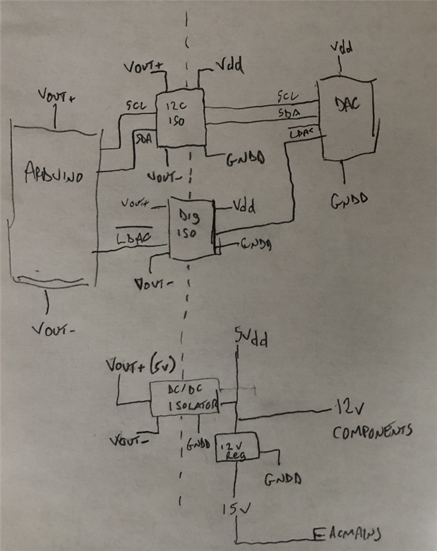

I'm working on something where I use an Arduino talking via I2C to a DAC, an ADC and an RTC and I'm provisioning an I2C isolator and a digital isolator (for digital pins) to provide separation between the two.  I'm doing this to prevent blowing up the Arduino if something goes wrong and also just because I want to as part of experimenting/learning.
This only works if both power and ground on sides A and B of the isolators are separate from each other.  To complicate matters, if this all works and I encase it then I only want one power cord into the case - something like a 15V wallwart affair.  This would, inevitably, tie grounds together and the isolators won't work: not 'won't work in an isolation' sense, but not work at all - I've tried it!
So I'm wondering if I could feed the 15V supply into a 12V regulator and subsequently a 5V regulator for Side B (I need 12V and 5V on that side) and into a 12V DC-DC isolator that outputs 5V for side A which also powers the Arduino.
Something like this Tracopower supply.  When I look at this I see that the Vin ground is connected on Side B, but the Vout -Ve is isolated for Side A so it seems like it would do the trick.  I thought I'd ask here first before committing to spending money to try it out or indeed if there were other ideas.

    jw0752 over 5 years ago +3 verified
    Hi Andrew, Yes this is an isolated DC to DC converter and it will provide a voltage that is not common to the input voltage. this should allow you to do what you are talking about though I am not weighing…
    jw0752 over 5 years ago in reply to Jan Cumps +3 suggested
    Hi Jan, I believe there were two models listed on the data sheet. One had +/- with a common and the other was just +/- with no common. If I read it correctly both of these options were isolated from the…
    Jan Cumps over 5 years ago in reply to Andrew J +3 suggested
    If you need single output, you're good. The output is isolated. If you want me to pre-check something, I have one of the same family;

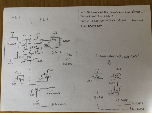

    Side A: Arduino providing I2C comms to the isolator.  On this side is also power to an encoder and power button.
    Side B: I2C comms to DAC, ADC and RTC.  There's also a 5040 voltage ref.
    Here's a pic (I missed out pullup resistors, caps, bypass and reverse voltage diodes etc to avoid cluttering):
    (NOTE: on the image above, I've shown Vin and GND to the Arduino which would be the case when not connected to the PC during testing/development.  When I was trying this on the breadboard, the Arduino was powered over USB from my PC)
    What I have above doesn't isolate at GND - but avoids having two power inputs (what I have drawn on the right) and I thought it might be 'good enough' if I tied the grounds under the trace to the left-hand 5V regulator.  As I mentioned I don't NEED isolation I was just doing it out of interest as much as anything.  I know Jan/Peter did this with their DC load to prevent any high voltage/current damaging the USB port of the connected computer.  They can provide complete isolation on both sides because one is powered by USB and one by a 12V supply; these can be bridged if the MCU isn't connected so both sides are powered by the 12V supply.  I absolutely didn't want to drive this with two separate power supplies either from a PC or, say, a 5V wall wart on top of the 15V wall wart and the Arduino is always connected.
    With the above setup (Arduino powered from USB), when probing the SCL line on the isolator Side B it was rising to +5V/falling to 0V as expected; however the SDA line on Side B was rising to +5V and was only pulling down a few hundred mV below 5V and in a very, very non-square wave form, with very occasional pull downs to 0V.  Trying different pullup resistors had only a minor impact on this.  When I did away with the Side A 5V regulator and took Side A 5V and GND from the Arduino, it all worked fine.
    So, my first 'good enough' stab at this won't work but if I swap the 5V reg on Side A for the DC/DC isolator it seems like it should achieve what I want.

    0 shabaz over 5 years ago in reply to Andrew J
    Hi Andrew,
    Why do the grounds on side A and B need to be connected? It seems as if the design could have the side A ground separated and still function. The only isolated supply that would be needed would require a 5V output for the Arduino. I might have misunderstood.
    Also, to simplify the power, could a 12V supply be used (not 15V) and then a 12V-to-5V isolated supply could be used?

    The grounds don't need to be connected, it wasn't a specific requirement.  In an ideal isolated world they wouldn't be.  What I wanted was to try and protect the Arduino, not to have to plug it into a PC to power it, and not to have two input power supplies - a 15V and 5V as drawn on the right in the image in the post above.  I have components that require regulated 5V and regulated 12V and the 12V regulator requires a minimum 15V input.  I can't power Side A from the Arduino once encased because the Arduino needs powering and I don't want to plug it into a PC or 5V wall wart (back to two sockets!)
    My first stab at that, because I didn't know any better at the time, was to isolate just the power and signal traces and not to worry about the ground as I drew above.  So the grounds are the same purely from initial expediency - saves some money as galvanic isolation isn't really required.  That doesn't work - the I2C isolator doesn't seem to like it (perhaps just because it's on a breadboard??) - so I need to move to my next idea which is to use a DC/DC isolator.  I can use either the 15V or 12V as input to the DC/DC isolator (12V is its nominal voltage.)  Now in terms of 'saving money' I was using a LM7805 as one of the regulators, which I have to hand.  That doesn't like powering the Arduino with a voltage drop from 12V to 5V - as I expected, gets too hot and goes into thermal shutdown eventually.  Given that I'd need something like the Tracopower 5V switching regulator - the other one on my image - at around £5 - I might as well not worry about saving £10 and just get the DC/DC isolator and get proper isolation.  So my question was really just making sure I was thinking straight, before I spent that £15 to test it out.  I probably provided more information than necessary and just confused everyone.  Still, it's led to another interesting discussion!
    (I forgot to draw on the 5V regulator on the right hand side where it is marked 5Vdd - imagine this is a 5V regulator!)  This then allows me to have one plug in the wall, no connection to a PC and drive both the Arduino and power components completely isolated from each other.  Again, I haven't put in all the caps, resistors, diodes etc.

    0 Jan Cumps over 5 years ago in reply to Andrew J
    A heads-up that sharing a ground is virtually the same as sharing Vcc. It's a closed circuit: a PSU output is very low impedance.
    for the current, and for any bogus current too, it is as if your power supply is a wire between Vcc and GND.
