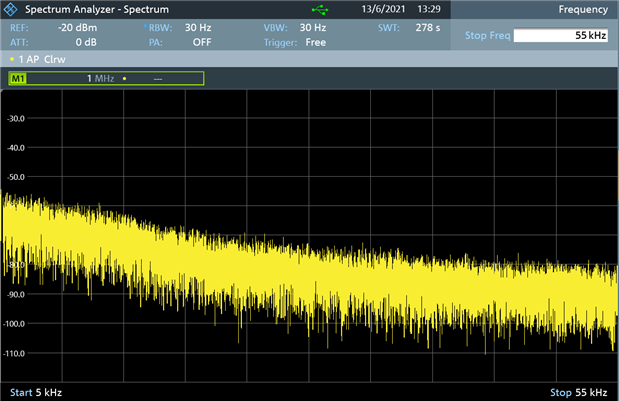

With no input signal I am seeing what I feel is an unexpected response below 2.5 MHz.   I will attach some pics to demonstrate.  I first noticed this on powering up or on a preset a yellow line spike can be seen on the far left of the screen going all the way to the top of the screen.  This is there but hard to see in the screen shot.   When the frequency span is adjusted it is clear that the noise floor rises rapidly below 2.5 MHz.  (see pic #2)   The data sheet indicates a 5 KHz - 3 GHz operating  bandwidth.    I have gone through some of the specs and it seems otherwise to be operating within them.  Am I seeing a normal and expected behavior or is there an incorrect setting or something misbehaving?   Lowering the BW limits do improve this but there is still a sharp rise approaching 5 KHz. rise .  Perhaps this is a just a firmware glitch?  (Firmware v1.60)

    If you want to get the lowest line visible on the SA, the resolution bandwidth needs to be reduced to as low as possible, otherwise it is showing the power across that value (generally, although it depends on the shape of the internal filter). So in this case, the power in 1 MHz of spectrum is being displayed, but the FPC1500 can be set down to 1 Hz, although then that means the sweep rate becomes impractical, unless the span is greatly reduced, so it becomes a compromise.
    Also, the noise floor is only specified from 1 MHz in the datasheet. Generally most spectrum analyzers will not perform well at these very low frequencies, if the performance metric is the noise floor, however they are still usable at those frequency ranges.
    Here's my attempt for a 5kHz to 55kHz range (with 50 ohm terminator at the input), at 30 Hz resolution bandwidth, which took almost 6 minutes to complete a single sweep, so at 1 Hz it would have been much better, but would have taken too long.
    At the 30 Hz resolution bandwidth, at 5 kHz the noise level is perhaps -55 dBm (will reduce with averaging), and it rapidly improves, so that at 55 kHz it is below -80 dBm (and again averaging, or a lower resolution bandwidth, or using the preamplifier, all will improve it).

    Thanks for taking the time with that explanation shabaz.  I realize that this is not designed as audio spectrum analyser. Just wanted to make sure everything is operating appropriately. (except for this inexperienced operator !  image ) Looks like everything is working as it should then.  I was able to reproduce the identical sweep as your screen shot above and confirmed all is working well.  I have been going through all the modes and features systematically.  Still using your review for a reference.  Having loads of fun with it.  Now fumbling around with the VNA capabilities with which I have really no experience.  For example, I noticed that the sweep bandwidth is more limited and some of the settings that are available in spectrum mode are not available in VNA mode.  I assume that is a technical reason for that.
