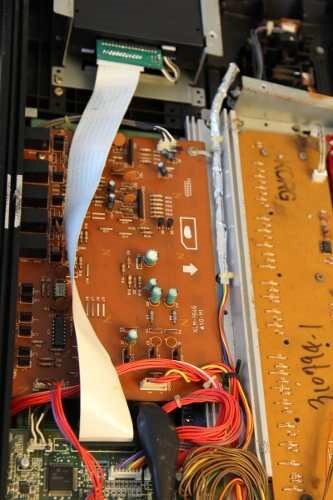

    0 dogrox over 12 years ago in reply to Problemchild
    okay this is not my picture. But they're doing the same thing inside their Korg x3 keyboard. They're using an adapter as I am using an adapter but its not the same one. The one I have has the ffc connector that's just the opposite where the contacts are up instead of down. Hence why i need opposite side contacts..type d. You can see he is twisting thr cable, but dont go by that becuase in my case doing that will reverse the pin wiring.  Everything on the other end of cable is the korg board thats stock and i like to keep it that way.:-)
  • Problemchild
    0 Problemchild over 12 years ago in reply to dogrox
    I agree just that what I interpret your question as and someone else can often be different pictures are king and all that image

  • Problemchild
    Hi there a picture of the cable if it's still about will help failing that a picture of the two ends so folk can guess the connector type.
    The 1.25mm pitch is just standard since that's what is used to connect to 2 rows of .1" pitch connector.
    Normally you'd be looking at some 26way ribbon and two IDC connectors so to be more accurate you may be best to take that photo
