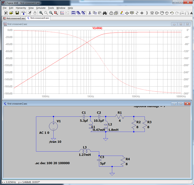

Hello, new here with a question regarding Lpad resistors.
mrsouth
mrsouth over 5 years ago
First of I'm new so Hi,

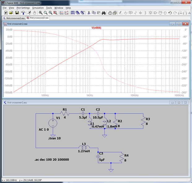

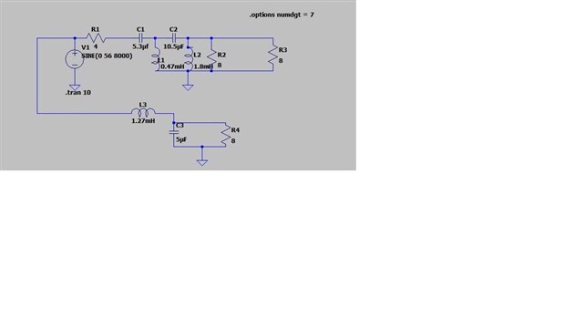

     I have been messing about with Lpads (I have a few horns I need to tame in P.A enclosures).  I have created a crossover in LTspice, added the appropriate Lpad resistor values then I ran a simulation to check everything over.  First the voltage supply was set to 56V (level required to drive 8 ohm speakers to their rated 400Watts) and set it as a sine wave at 8Khz.  The crossover and Lpad are definitely working as designed (tested with pink noise source and checked fourier as well), however the the first Resistor in the Lpad (R1) is dissipating 120Watts.    Which seems at odds with the 30Watt resistors I've seen in similar rated speaker cabs.  Our overlord google.com has told me they don't need to be high wattage resistors,  but the circuit and simulation here (designed using commonly available calculators) tells me otherwise.
R1 and R2 are the Lpad, R3 is the horn.
The rest being a 4th order for the horn and 2nd order for the woofer.
Any Ideas what I am doing wrong?
Many thanks.

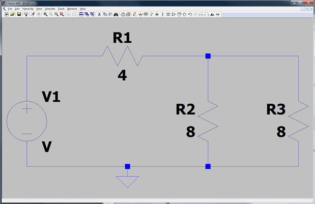

    With a 4 ohm series resistor and the 8 || 8-ohm = 4 ohm load, they form a voltage divider of 4/8 = 0.50 or 50% of the input maximum gets to the output. This means you lose half of your amplifier's output in R1. That's not a great design. There are better ways of designing low pass and high pass, passive filters that avoid high losses like this. A better way is to Bi-amp your amplifier by using two smaller amps that each have an active filter between the pre-amp and the power amp so that you avoid high losses in the filtering and virtually 100% of your amp's power goes to the load.

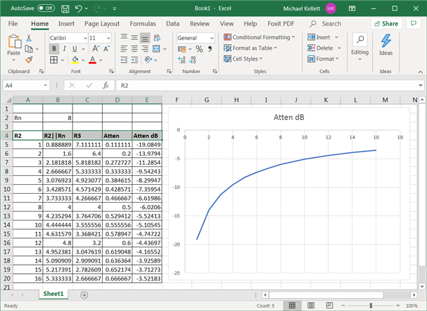

    If you need more attenuation then just alter the LPAD resistors.
    The rules are:
    Rn = R3 = 8 (impedance of horn driver), Rn||R2 is the impedance of the horn in parallel with R2
    Rn||R2 = 1/(1/R2 + 0.125)
    R1 = 8 - Rn||R2
    Attenuation = Rn||R2 / 8
    You can solve the equations (not before breakfast) so I did a little Excel spreadsheet:
    (all these tools make us lazy !)
    MK

    Thanks Michael,  yes active and more amps is an ideal long term goal.  At the moment though I need to keep the system simple.     If you look at your graphs you will see that with R1 before the filter the horn is several dB lower, but when it is after the filter the reduction is not there (or at least not as predicted by the calculator).      I think this is one of those trade off things where you have a triangle and you can only have two of the three.
    EDIT: I made a mistake reading your graphs, the upper range of one is 20db higher.  So while it looks like there is more attenuation on the second circuit, it might not be.    Something I need to look into before I make the final.

    I think you have R1 in the wrong place - the idea of the Lpad is to make two resistors look like the same impedance to the drive source.
    R1 in orignal position, filter sees 4R load and 4R source
    R2 in correct position, filter sees 8R load and 0R source
    I expect that you know that you will get much better results with an active crossover and two power amps.

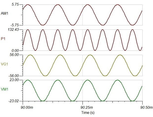

    It looks like you got the same outcome as I did,  I think I measured 122W across R1 (if I'm being accurate),  which if we account for average power and the fact that a music signal will likely be even less,  then it seems everyone has come to basically the same conclusion.  My mistake was not accounting for that.    I will find an actual music source and run the simulation again.

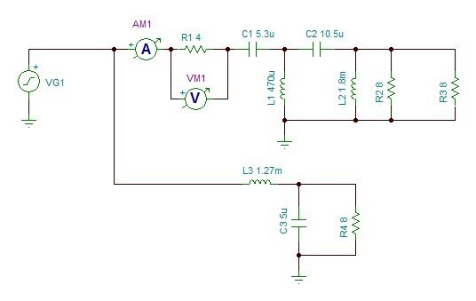

    With Tini-TI, I can also do things like this (I imagine the same goes for LTSpice, or there will be another way to achieve the same end):
    Here I'm measuring the current through the resistor and the voltage across it and then using the post-processor to calculate the product of the two.
    This is what the result shows for an 8kHz 56V pk sinewave from the generator. That's showing a peak of 132W, so an average of about 66W in the resistor.
    Be wary if you decided to give Tina-TI a try. There are some bugs with displaying the postprocessor results (at least, with the version I've got there are). With more than one calculated curve, it will only display one of them correctly, the rest being wrongly shown as a duplicate of the one that it gets right.

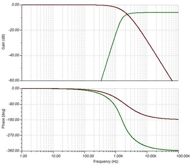

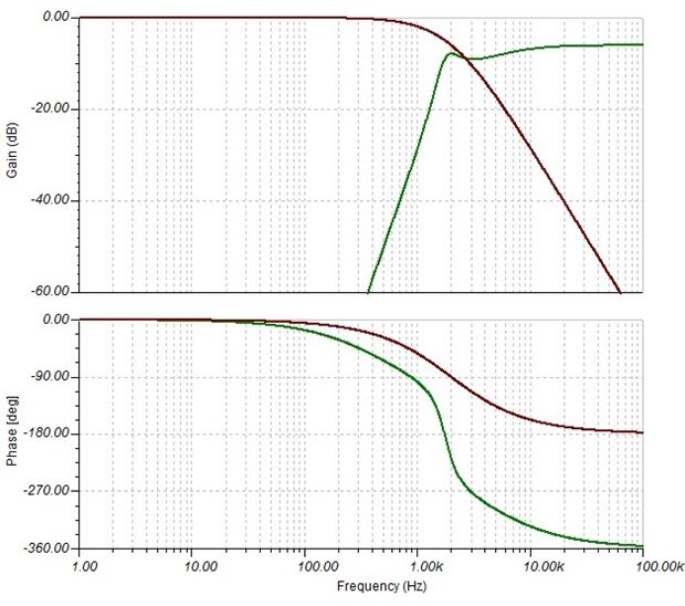

    I don't understand anything about crossover design. What was the rationale for adding R2 to the circuit and lowering R1 to 4 Ohms to match? Is it because the horn is starting to look somewhat inductive as you go up towards 20kHz?
    It looks to me like the filter was probably designed for 8 Ohms (with the assumption that the horn load was resistive). At 8 ohms it has a smooth Butterworth response. As you've got it here, with the resistors either end changed to 4 Ohms, it's halfway to a Chebyshev, with ripple in the passband. (As I said, I don't know anything about crossover design, so maybe it's all very, very clever and compensates for the horn response, or something.)
    This is the response as you've got the circuit (R1=4, R2=8) (red=woofer, green=horn)
    This is how it would be at 8 Ohms (R1=8, R2=infinity)
    One thing to notice from both those is that the 4-pole horn filter has a very abrupt phase change at cut-off, where the woofer is still sending out a modest amount of sound. Wouldn't that then acoustically result in some cancellation between the horn and the woofer? If so, you may find a bit of a notch in the response around 2kHz when you physically test it.
