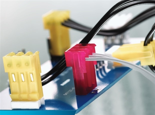

    Many crimp connector series include panel-mounting housings.
    As an example, this link is a Molex Mini-Fit Jr plug housing which will clip into a panel.
    https://www.molex.com/molex/products/part-detail/crimp_housings/0039012066
    They're intended more for wiring harnesses to internal bulkhead panels in industrial and consumer equipment, but if you're not too fussy about looks and just want something that's functional they might do you. The specialised crimp tool is very expensive, but the crimps are large enough that you can solder the wires to them as an alternative, or if you're careful just use a pair of pliers. TE Connectivity also have a huge range of different parts.

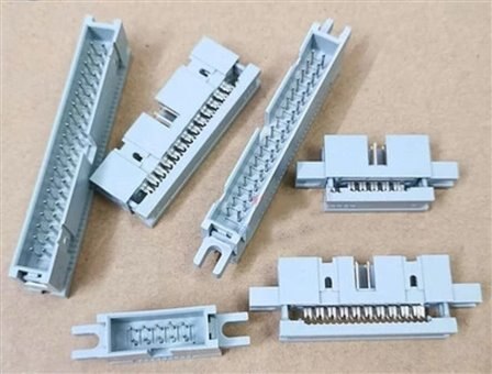

    Regarding IDC connectors, there are some that are panel mount but they are more rare. This one maybe:
    https://uk.farnell.com/3m/4620-6000/header-idc-lugged-20way/dp/469166
    (It is panel mount but would use ribbon cable, to the PCB, or strip the other end of the ribbon cable and solder to the PCB or whatever).
