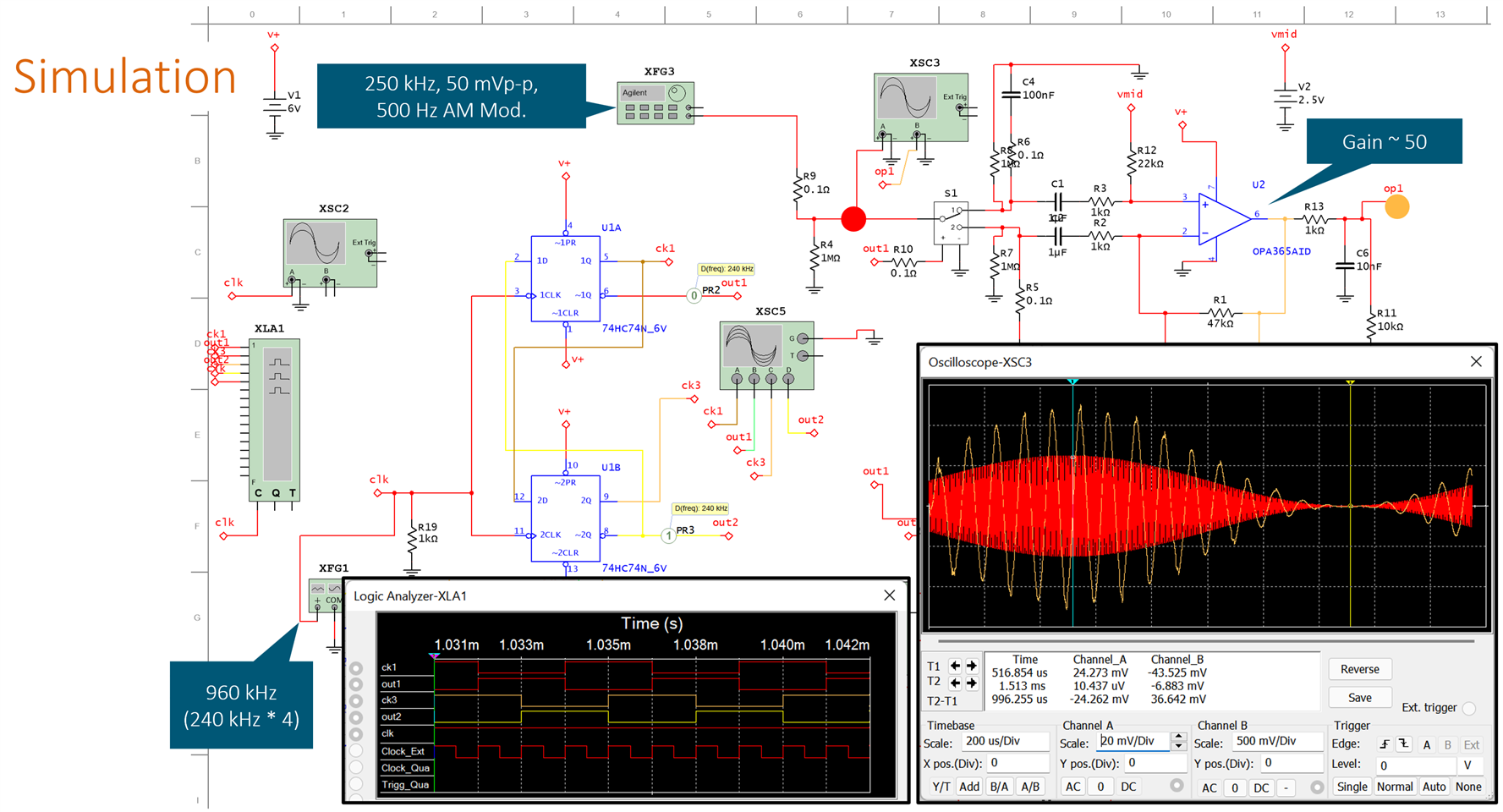

    An example of Multisim in use (this is a slide from a talk I was supposed to give to some Amateur Radio people at some point, so I had it pre-prepared).
    The red and yellow blobs on the schematic are just graphics I added to show where the red and yellow output on the oscilloscope view came from (it's showing frequency conversion from the mixer). On the left you can see the divide-by-4 and quadrature signal generation.

    Just to add to the simulation ideas, Multisim is pretty easy-to-use for simulation, it tries to show things during execution-time, i.e. allows the user to watch behavior as the simulation runs in short time-bursts that make it look real-time even though it isn't, rather than execute the entire simulation and then observe the recorded results after the simulation completes. It's pricey (typical of NI), but a low-cost way is if you have young family-members (doesn't need to be son/daughter from what I can tell, can be extended family, of school-going age) and then there is a discount. I used that to simulate large chunks of an SDR project I worked on a while back (even though it's not really designed for RF stuff).
