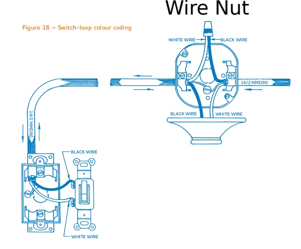

    What happens in a wire nut? Do you simply twist the cables together and put the wire inside the wire nut hoping it doesn't separate?

    So what is used to connect AC wiring if wire nut is not used?
    shabaz over 3 years ago in reply to colporteur
    Pretty much almost always screw terminals, like these ones which are part of a ceiling light fitting. They come in plastic encased blocks too.
    Plastic blocks that can be cut to the desired length:
    The plastic blocks above are nowadays less popular, most electricians here now prefer Wago connectors like the one shown below, which is Wago 221. They are pretty awesome, handy to keep some for quickly assembling cables without soldering or screwing, its just a plastic lever that locks or unlocks the wire. They are reusable too.
    dougw over 3 years ago in reply to cstanton
    The wire nut has a spring inside that you screw onto the twisted wire. It does a good job of accommodating different twist geometries and the spring is made of strong enough wire that you can twist it on tightly. It acts like a multi-layer noose that gets tighter as you twist, ending up with continuous force squeezing the twisted wires with even more conductive wire, and it won't spontaneously loosen off. The plastic thimble provides grip to twist and insulation for the joint.
