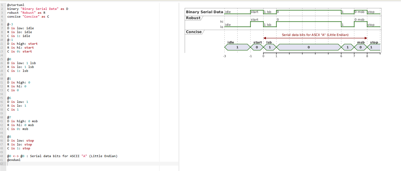

    I use plantuml a lot. You only need to download a java jar file and can execute it from the command line
    java -jar plantuml.jar sequenceDiagram.txt
    or use the online editor PlantUML Editor
    Timing Diagrams
    Sequence Diagrams

    I was just browsing sequence diagrams, and found a python library called seqdiag. It's easy to install (pip install seqdiag) and accepts input in a form like this:
    seqdiag {
      edge_length = 300;
       === Event: Button Press ===
      A -> B [label = "01 01 00 [START] Time=11:00:57.045"];
      A <- B [label = "00 [OK] Time = 11:00:57.509", note = "CRC ERROR!"];
      A -> B [label = "02 05 00 [HELLO] Time = 11:00:58:110"];
      A <- B [label = "02 05 00 [HELLO] Time = 11:00.58. 143"];
    And can output SVG like this:
    There;s an online version where any example text can be pasted in, and it will generate in the browser.
    Perhaps seqdiag or similar types of libraries can become part of custom solutions. Anyway, maybe it's completely not what you need! but figured it's worth just mentioning in case it helps even for unrelated stuff. I can see myself using such a tool in future too.
