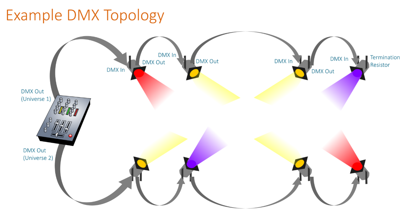

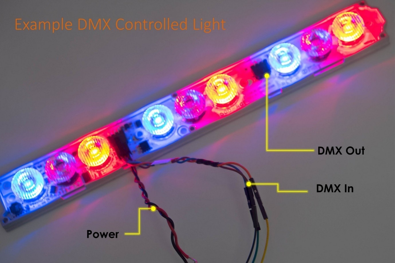

The photo here shows an example; this is a single multi-color light fitting, and the ‘DMX In’ would be attached to a lighting controller or a PC. The ‘DMX Out’ is not attached in this example. It would connect to another light fitting.
The light fittings are therefore chained, and the lighting controller will be able to address each one. There is a limit to the chain length (512, but the limit is often lower for reasons explained later) and so many lighting controller will feature several (or more) DMX outputs, so that additional chains can be created. Each chain is known as a DMX Universe.
The diagram here shows what a lighting set-up with DMX can look like; this example has two DMX universes.

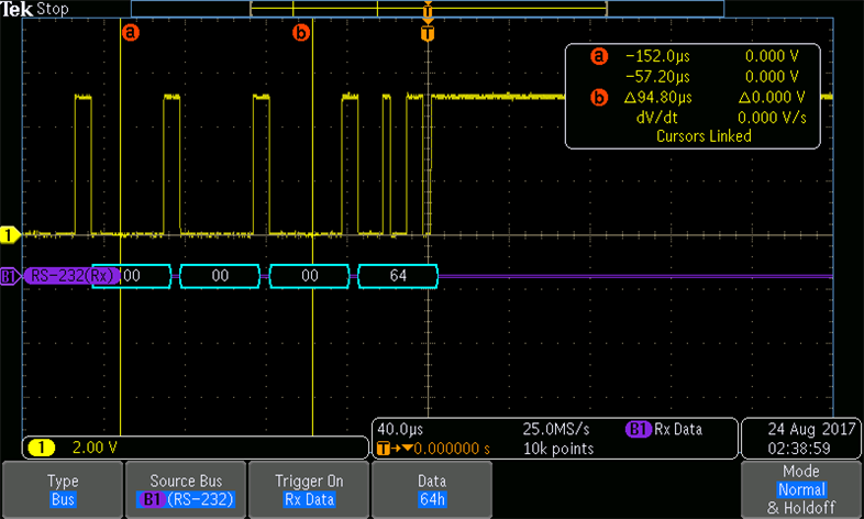

beacon_dave worked at Looking at the DMX 512 protocol with a Keysight EDUX1002A scope for a detailed analysis with real-world oscilloscope traces. He discovered some interesting things like unusually long delays in parts of the protocol. I too was keen to examine real-world equipment; I bought some Dialight LED modules ages ago, but I didn’t know how to use DMX until I examined Dave’s article.
Since I had a USB-to-UART bridgeUSB-to-UART bridge, I figured I could build a custom controller for the LED modules. But first I wanted to snoop the traffic and examine if it was similar to Dave’s findings, or different in any way.
This blog post doesn’t cover the design of a controller, but is intended to document the DMX protocol with real-world traces, to complement the work Dave did. Together there are now two practical examples of DMX implementations, so that it is possible to build solutions with high levels of interoperability.

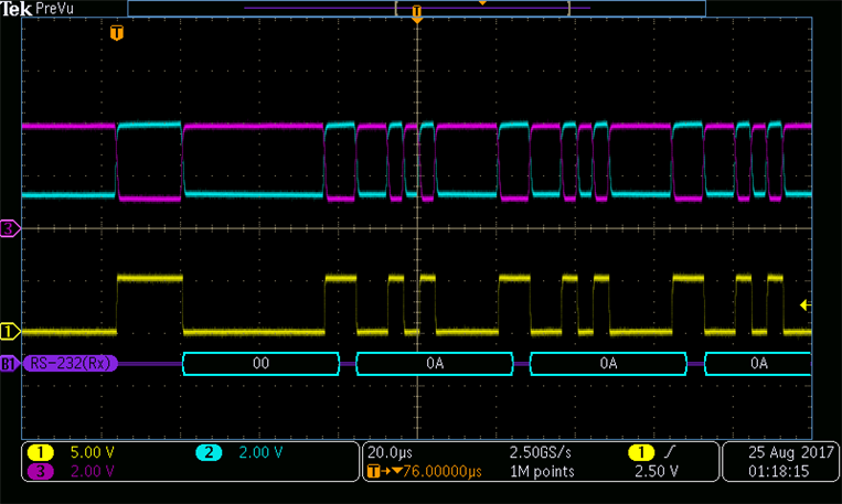

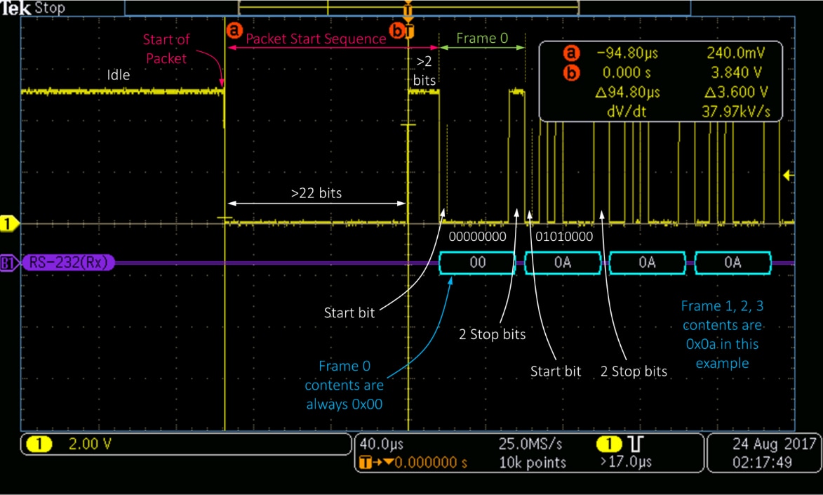

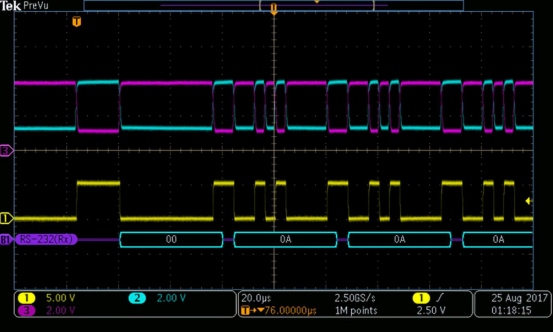

A picture says a thousand words. The oscilloscope trace below shows in yellow the logic level signals corresponding to the data stream of values (in hexadecimal) 0x00, 0x0A, 0x0A, 0x0A. The bits/bytes will be examined later but for now we can examine the voltage levels. The yellow trace is a 5V logic level signal suitable for 5V microcontrollers.
The blue and purple traces are the A and B lines respectively. The blue (A line) trace is non-inverting, and follows the yellow trace (although the voltage levels are different). The purple trace has an opposite phase. The point of this is that there is a greatly increased threshold to protect against noise when the signal is received; this is the key advantage of balanced signals. The oscilloscope trace was taken by snooping the RS-485 communication from a commercial lighting controller. A MAX485 device was used as the receiver to perform the snooping operation and the blue and purple traces correspond to the signals taken from the pins marked A and B in the MAX485 data sheet, with reference to the 0V signal.
So, this explains the voltage levels. From here onward, only the yellow trace will be shown, and the line A and line B signals will not be shown. We can now examine the data format and what the bits/bytes mean.

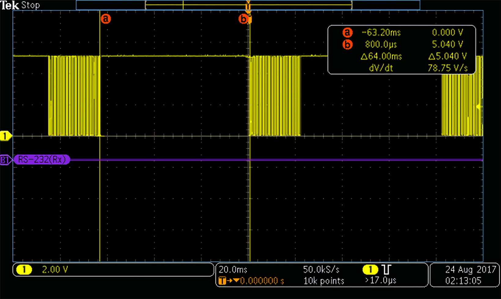

With the equipment I tested, I saw that approximately every 70 to 90 milliseconds, a packet is sent (i.e. a start-of-packet procedure, followed by 513 frames) and then the line goes to idle state again. The 70-90 millisecond period can vary and the exact value is unimportant generally, except it will matter when lighting effects (like fading transitions) are required.
The screenshot here shows three packets and the long idle periods in-between.

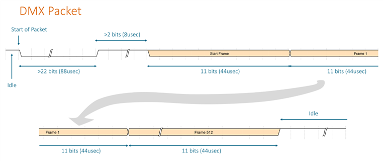

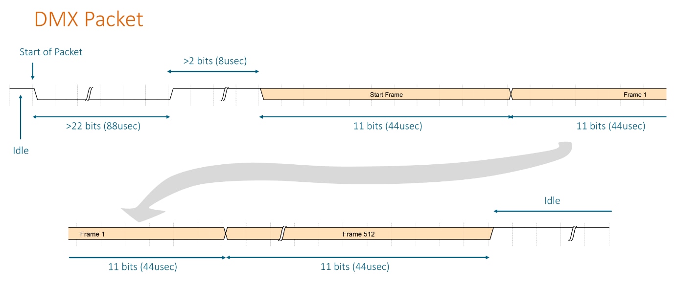

The diagram below (click it to enlarge for detail) shows one entire DMX packet, starting with the line idle (logic 1) and ending with the line idle again. This will repeat every 70-90 milliseconds with either the same packet content if the lighting levels are to remain the same, or with changed packet content if lighting effects/transitions are occurring. It follows that just over ten discrete steps per second are therefore possible when performing lighting transitions, if the packets are being sent every 90 milliseconds. If no packet is sent, or if there is a long delay between packets, then the lights will remain at the previous set level until the levels are updated by new packet content.

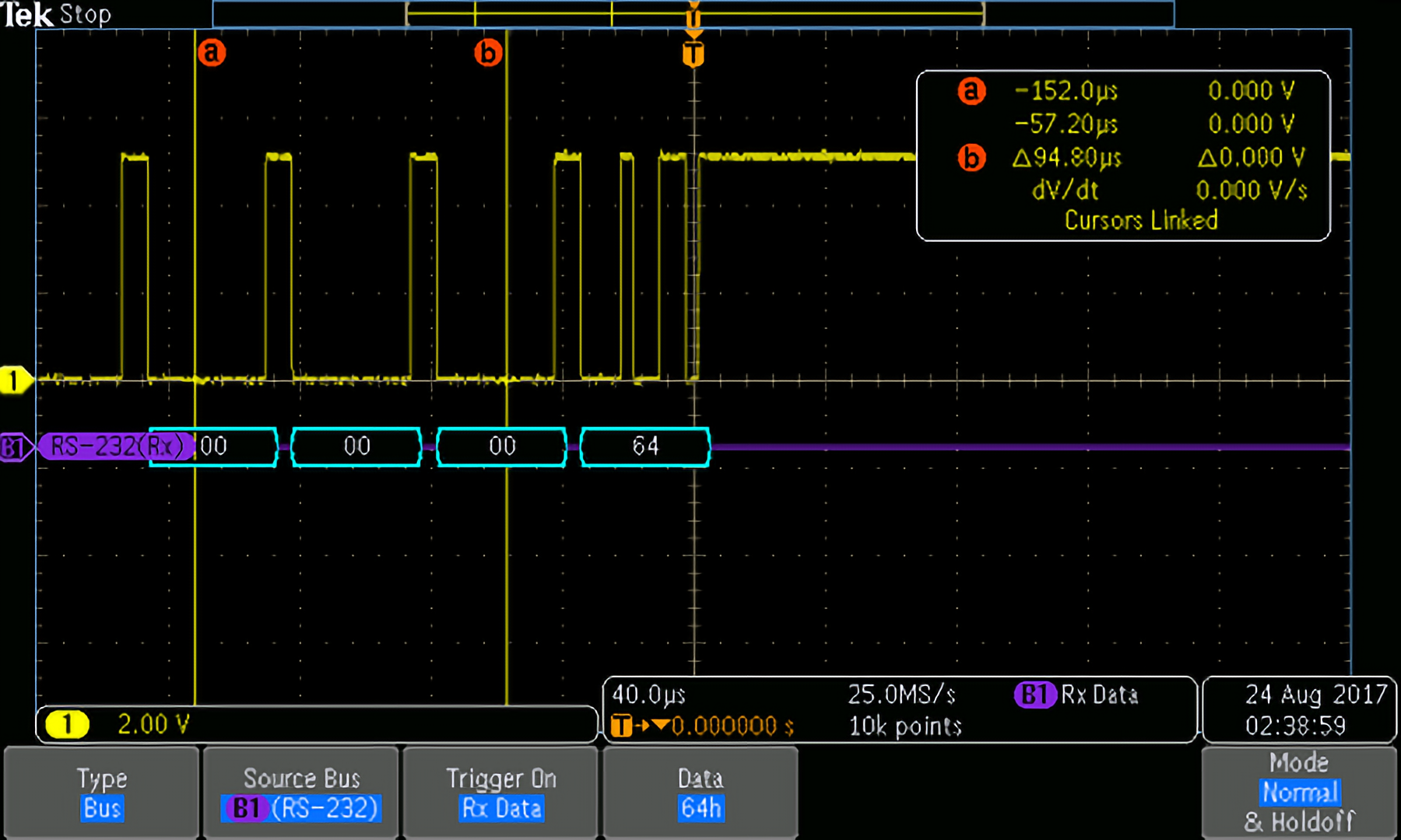

The start-of-packet procedure is a logic zero for more than 22 bit periods,followed by a logic 1 for more than 2 bit periods.
The packet represents 512 different light levels. In other words, per packet, 512 devices could be addressed. There are 513 frames, and the first frame (frame zero) doesn’t correspond to a real device. For lighting applications it always contains a hard-coded data byte set to zero, and is known as the start code or the start frame. Apart from the fact that the data byte inside this first frame is set to zero, it looks just like any other frame. Note that if this start frame's byte contains any value other than zero, then this means that the packet is being used for a non-light application such as pan/tilt. The entire packet should be ignored in that case.

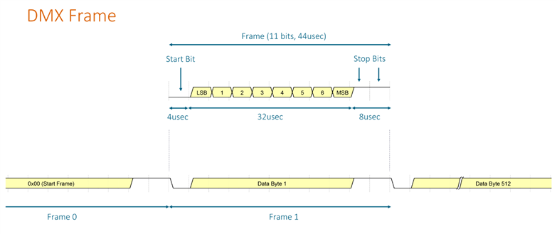

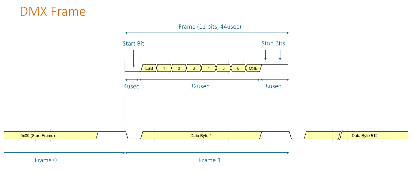

If we look inside any frame, we can see that it consists of just a single byte wrapped around one start bit and two stop bits. The start bit is zero, and the two stop bits are high.
The packet’s first frame byte content is always 0x00 for light applications, and then a further 512 frames are used to select the levels of 512 lights. These are logical lights, since each physical light fitting may contain red-green-blue LEDs, or even red-green-blue-white. That being the case, the 512 logical lights can be used for (say) 128 physical lights if each one is consuming RGBW values. If there are just RGB lights (i.e. three channels or frames used per physical light fitting) then up to 170 physical lights could be supported. If there are just single-color white lights then up to 512 of them can be supported.

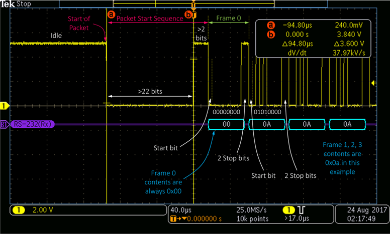

The packet starts with the start-of-packet procedure which as mentioned is the bus going to logic level 0 for more than 22 bit periods (88usec; in practice I saw 94usec) and then high for more than two bit periods (8usec but in practice I saw around 16-24usec). After that, a total of 513 frames are transmitted, and each frame contains a logic zero start bit, eight data bits and two logic ‘1’ stop bits.
The annotated ‘scope trace below shows the >22 bit-period logic low level, followed by the >2 bit-period high level, followed by the frames containing 0x00, 0x0A, 0x0A, 0x0A. These are the start frame, and frames 1, 2, 3.
The first frame has a byte that as mentioned is 0x00 for lighting applications (ignore the entire packet if you see a different value!), and then the subsequent 512 frames contain the light levels. All bytes are sent least significant bit (LSB) first. The trace screenshot above shows that the first three light levels are set to 0x0a (decimal ten) which is quite dim (the range is 0 to 255).
Incidentally the frame number is known as the address in DMX terminology. So, in the oscilloscope trace above, DMX addresses 1, 2 and 3 are set to 0x0a (decimal 10). They are also referred to as ‘channels’. It is all a bit vague : ) but the terms represent the same thing.
Since each frame consists of a logic zero start bit, then eight data bits and then two logic ‘1’ stop bits, this means that each frame takes up a total of 44 usec (4 usec to send the start bit, 32usec to send the 8 data bits, followed by 8usec total for two ‘stop’ bits). Immediately after this the next frame is transmitted in the same manner.

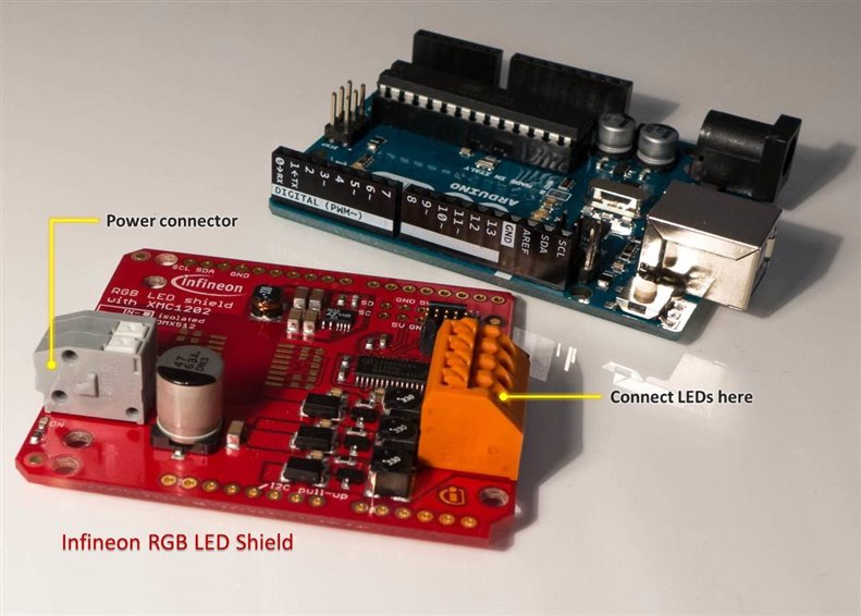

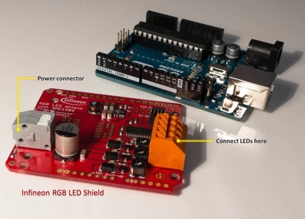

For low-cost experimentation, the Infineon RGB LED Shield for ArduinoInfineon RGB LED Shield for Arduino is very useful; it has terminals to connect up RGB LEDs and space on-board to solder an RS-485 transceiver chip. The on-board Infineon microcontroller can be programmed to interpret the DMX packets and control the LEDs.
Incidentally it could also be used as a lighting controller, if no LEDs are attached to it, provided the software is changed to operate in this manner as a DMX Out (RS-485 Master) device, perhaps under the control of the Arduino board that it plugs onto.
See here for more information on it: RGB LED Shield from Infineon - Getting Started Guide.
