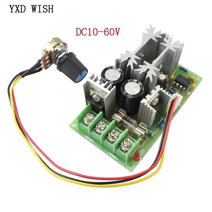

 new to the forum/site and hope to learn from this venture. Have a lot of experience in automotive and aerospace tech. Have tinkered in electronics and computers. A lot to learn :^)  Currently attempting to build a DC motor controller for my grand daughters ride on Jeep. It has an on/off switch for foot speed control, want to make a variable controller. Any suggestions would be appreciated.
    dougw over 3 years ago +2
    You could buy a PWM motor controller for $6 with a potentiometer speed control that you connect to the foot pedal.

    Do you need the motor to run in reverse? Be sure to select a pedal design that cannot stick in full throttle.

    I recall that there was a ride-on conversion project a couple of years ago. /challenges-projects/project14/theholidayspecial19/b/blog/posts/5000w-dual-drive-electric-car The throttle pedal was replaced…
